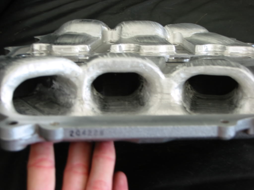

yes, i believe there are a very small gain on the high end. search on my350z, Tony from MD said something about it. i modded my stock lower plenum into a "MREV2 look-a-like" and port and polished it.

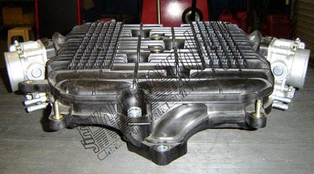

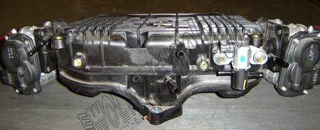

4. The alleged front cylinder air starvation "discovery" described on the Crawford site as a "sharp upper RPM power drop" was nothing more than the ECU closing the throttle body as redline approaches. TS figured this out while the Crawford boys got out the saws and torches when they started fooling around with their flow bench. Unfortunately, an engine does not draw flow that way in operation. Valves snap shut and open creating complex waves and reflections. That wedge helps direct the amplitude of the reflected wave to assist cylinder stuffing, not to clear a strut bar. The strut bar could have easily been formed to clear a flat plenum if that was the best plenum design. But obviously it's not since the '07 plenum is also angled down in the front and there is no strut bar to clear. See pix.
5. Anyway, I have yet to see any functional evidence of over rich front cylinders on a stock motor. Has anyone taken a multichannel exhaust gas analyzer and tapped into each exhaust port to measure A/F ratio? If the front 2 cylinders are as "air starved" as everyone says, they would be running rich wouldn't they? Not likely in this age of fuel mileage and emission regulations that the Nissan engineers would allow 33% of the engine to be running pig rich. The plenums and spacers are increasing overall volume and available flow, they're not "balancing" jack. If anything, the flat style plenums are altering the designed balance whereas the MD approach increases overall volume and flow while retaining the wedge effect.
Attached Thumbnails any HP gains by having Mrev2 ported/polished-dsc00843.jpg   any HP gains by having Mrev2 ported/polished-dsc00844.jpg
