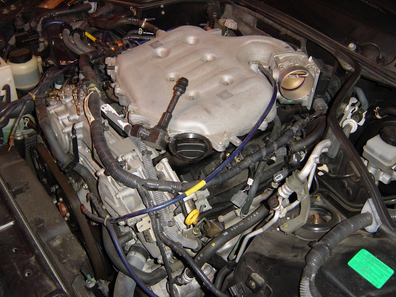

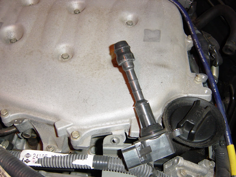

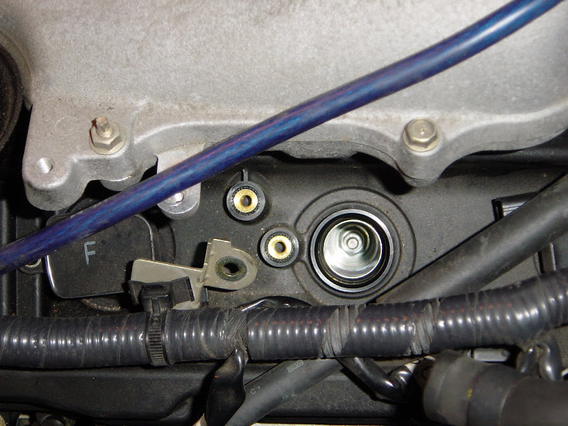

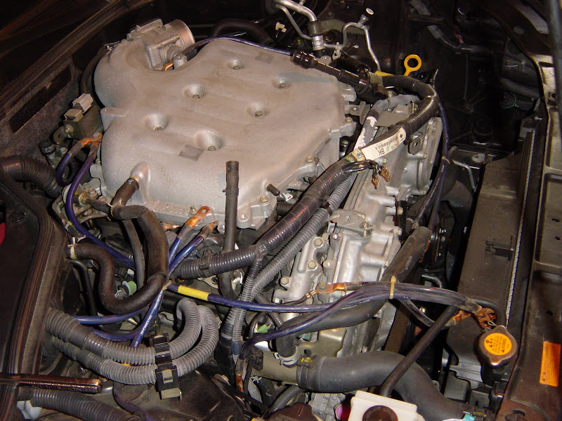

So I finally checked today. Bone dry on all 6 coil packs. I am not even sure if that is good or not. I didn't take the spark plugs out, I wonder if it's possible that coil packs are dry but the spark plugs may have oil on the bottom (which I would need to take out to check). I don't know how you guys did it in 1 hour. I must been in the garage for 5 hours. The drive side coil pack, 2, 4 and 6 was quite easy. The passenger side 1, 3, 5, is horrible. I couldn't figure out how to move those ignition wires away so I barely have enough room to check 1, 3, and 5. Had to do them one by one and of course drop bolts, that's another story and putting in wrong screws when I put everything back.
Since the coil packs are dry, I am not touching it again even though i have 2 more months of powertrain warranty. Just didn't want to go through the process again. I only have 38k miles so I will wait a while before I swap the spark plugs.

For everyone that had the oil pooling issue. Did you ALL see oil pooling before pulling out the spark plugs? Meaning there was oil pooling around the coil packs.
Did anyone have dry coil packs but when they took spark plugs out, there was oil on spark plugs? I am a bit paranoid now because my coil packs were all dried but I didn't pull the plugs out. It took me 5 hours and I don't want to ever do it again.

If you have dry coil packs you are fine...for now. I'm pretty sure all VQ's will have the problem eventually.
The spark plug tips may have a small amount of oil on them, but I really don't think that's anything to worry about unless it is a thick coating. All engines have a small amount of blow by that will collect on the plugs. You only run into problems when it is significant enough to start causing misfires.
