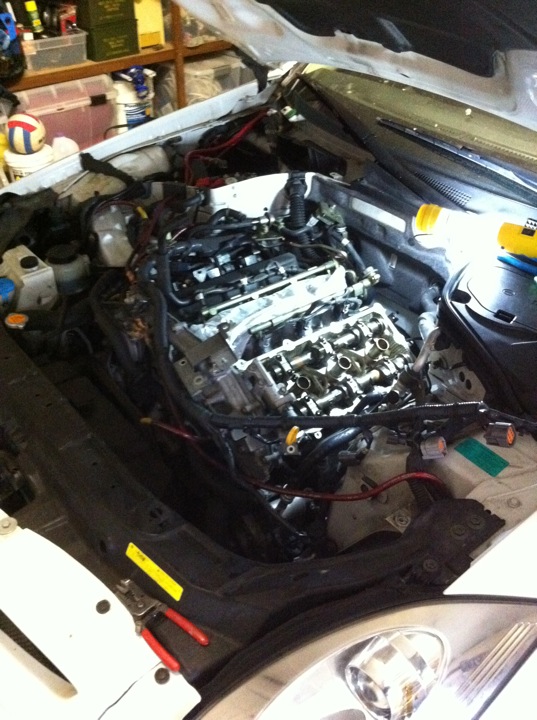

Would have been nice to know that I have to drill out my valve covers before I had ordered this in December or at least before I ripped my car apart. Its not reasonable to expect DIY'ers to drill out the VCs without access to proper machinery. Im fckin pissed! Look at the pic, now what, I have to go buy new valve covers which is the reason why I got these? My car is useless for now. I really hope R&D makes this right.

Sorry to hear about it dude, but no one ever said these were a direct replacement, so you haven't done enough research about it before you purchased the product. If this was the case Nissan would be selling replacement grommets and people wouldn't be forced to purchase two brand new covers. Also, before blasting away at R&D on here, contact them directly and see if they'll help you out first. Good luck man. Try getting a complete kit and send the grommets back if you can. The only issue is that they might not have enough covers to work on, since I'm still waiting on mine. I'm a patient man though.

Just got put in a very crappy situation.
Per R&D post:
"The kit will come with both driver and passenger side valve cover gasket, six o-ring gasket and a simple instruction how to replace them."
Theres nothing simple about it, you need to drill out to 1-7/8" per plug hole, accurately and centered. I don't know of anyone whom can do this simply and I'd like to think I'm fairly handy.
I called R&D and spoke to Lance, I let him know what's going on,he said he'll see what he can do and call me back. I'll post back the outcome.

I'm not sure how you know about the R&D Factory grommet/seal kit and not know it requires drilling out the old seals... it's been discussed quite a bit in various threads...
I will agree though that not enough details were originally given about how this kit worked... and I understand that everyone doesnt read all threads about this kit... so I can see how it could be misleading... But the leaking seal issue has been discussed a bunch in a lot of places and the common factor is the seals are molded in and cant be replaced (that's why R&D came up with this solution).
So it's kinda hard to be pissed about something that is seemingly so obvious. I'm not trying to be crass or rude, just being real.
I hope you get it worked out though.

Sorry fellas, not trying to be unreasonable. It's just from what I had read, which may not have been everything about these, led me to believe this would be doable at home. At the very least that it would come with the "simple instructions" so I would have known before dismantling and seeing that it's not made for home use. I knew they would have to be drilled out, and the pic I saw on page 5 by R&D of the VC seemed doable, but i didn't realize it was a cut-away with the bafffle removed. Did I read every thread on it, no. But all the posts I saw, including ones from R&D, made it seem like a fairly straight forward fix. I'm not knockin the product, Im actually glad a company can provide a fix for us that corrects what infiniti should have done. I just wasn't happy with my particular situation.
I have talked to Lance over at R&D and they are being great to take care of it.
