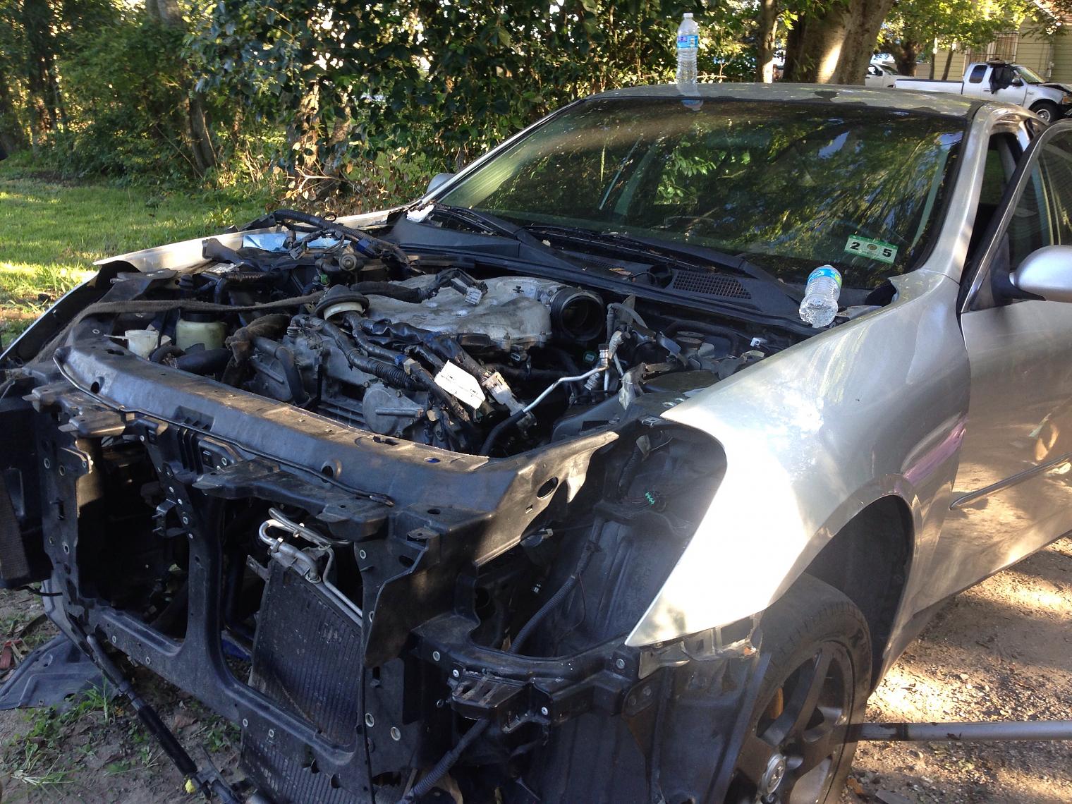

Hello. First thing I've always used forums for help getting my vehicles started, since I was 15 trying to get my 1977 ford ranger going and now I'm hopping it helps me get my G going.
I bought my 2003 G35 sedan 6mt for $2000 with a engine knock. Was quoted $2000 for used engine and labor payed 600 down and a month later the mechanic had done nothing but took my engine out (cosson auto parts) that's the crack head mechanic here in Houston. Anyways went for my car with a tow truck and before I got home I stopped at auto zone bought a Haynes manual and decided to do the engine myself.
I do body work and paint with some sheet metal work and I'm a quick learned so I knew it wasn't something I couldn't handle.
Four days later my engine is in my car but I can't get it to start lol is there a extra fuel reset stepped I missed or anything I should look for first??
I installed my own flywheel and there's a guide sticking out of the crankshaft that has to be slid inside the flywheel I marked my flywheel and made sure it went in the same place I'll post a picture of that guide, still is there a way I can see if I installed it wrong?
