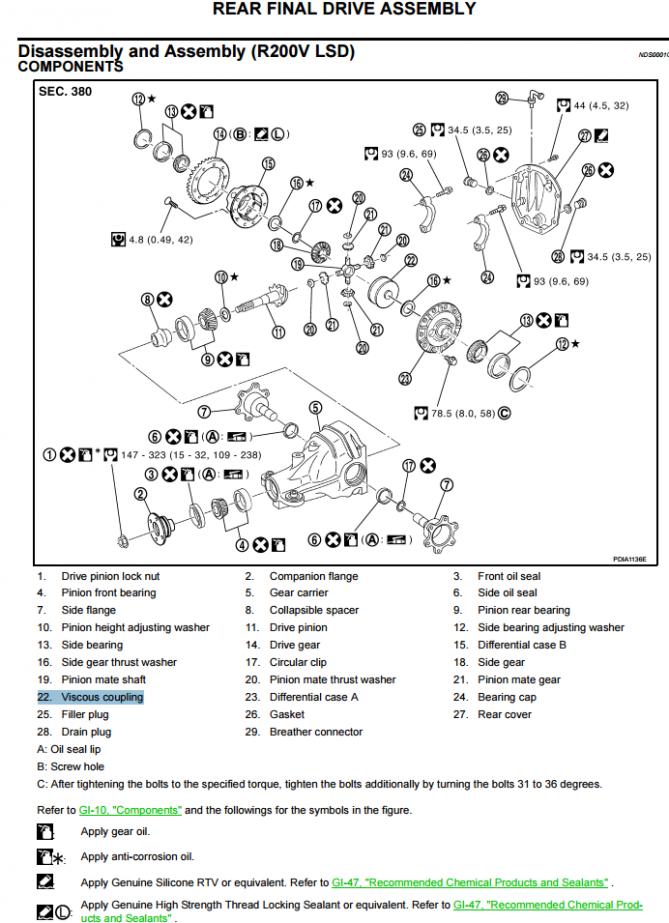

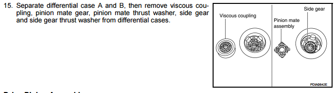

What is the actual wear item on the VLSD? Here is the service view of the Diff:

#22 and the oil, I would think
