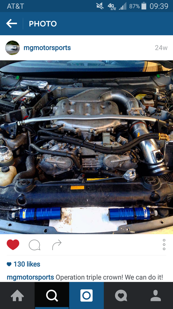

If you have an ig follow this guy. He had one of the most powerful NA vq35de's . The real problem with the plenum is the bottle neck at the top which you can see they tried to reduce. Also had an nwp tb.
Here is a link to his mod list and car running
Engine.
VQ35DE.
JE 12:1 compression pistons
Eagle Rods
JWT C10 cams intake. 300 degrees duration. 13 mm lift
JWT C9 cams exhaust. 287 degrees duration. 13 mm lift.
heavy duty valve springs. custom cam timing stop.
Multi angle valve job.
Deshrouded valves.
Ported Heads.*
Ported lower plenum.
Enlarged and gutted OEM upper plenum wih transition to 3.5" intake
NWP Throttlebody
UPREV GT MAF
3.5" Vibrant Cone filter placed infront of radiator
R35GTR Fuel Injectors
Walbro 255 fuel pump.
SGM Longtube Headers
3" Y Pipe
3.5" single exhaust. (custom)
Tuned with UPrev OEM ECU.
Innovative Tuning. Mustang Dyno.
335 whp. 278 lbft
