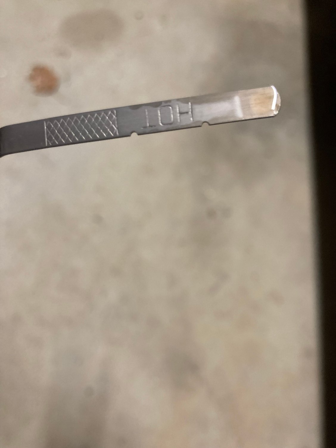

UPDATE:
I ran some errands, and drove the car 20 minutes there and back, with 45 minutes between trips. I then parked in the garage and performed Cleric's protocol (see his posts above).
Results are in. My conclusion is that I need to drain a quart or more out of the transmission because it is overfilled. The photo shows the level SIGNIFICANTLY below the level taken when the car was cold, but nonetheless high. It's a few ticks above the acceptable level for a cold car.
If I'm correct, this AT has been overfilled for possibly years. I bought the car in October 2020. It had 5 previous owners, so who knows how the transmission was maintained.

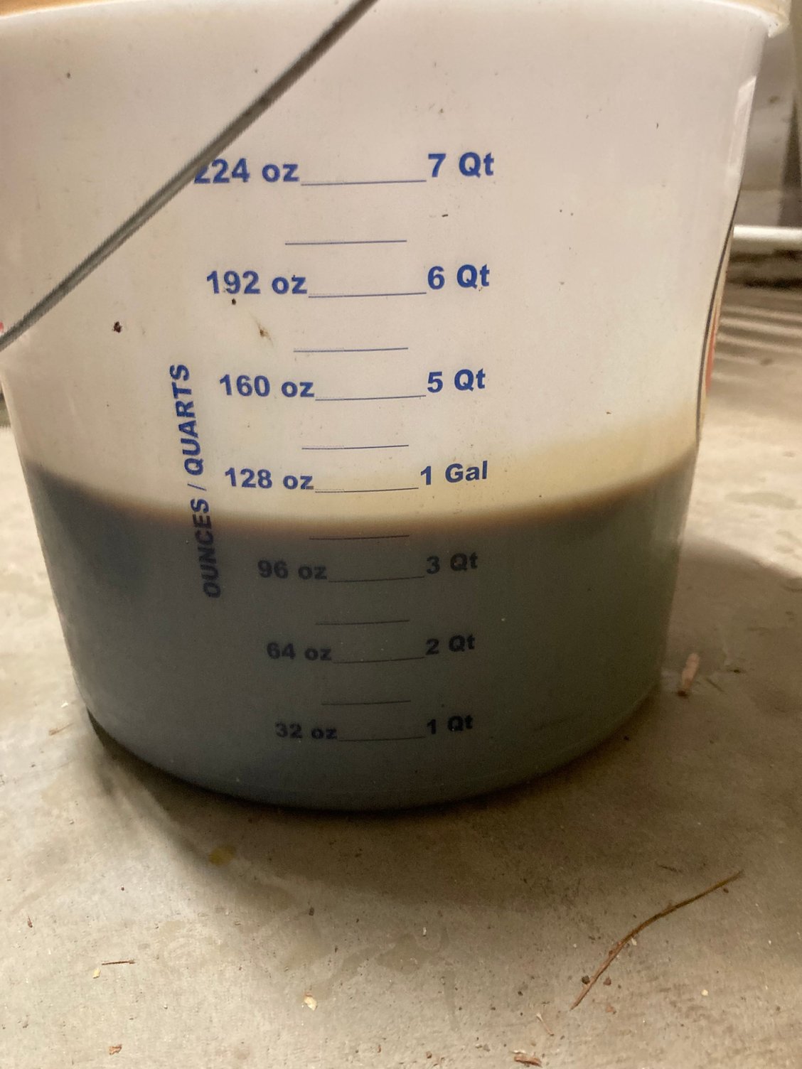

The photo of the bucket shows that about 3.7 quarts drained. I took the 4.0 measurement when the fluid was just out of the car, so it was still very hot. I suppose the level dropped when the fluid cooled down.
Advice, admonitions, or observations welcome, thanks.

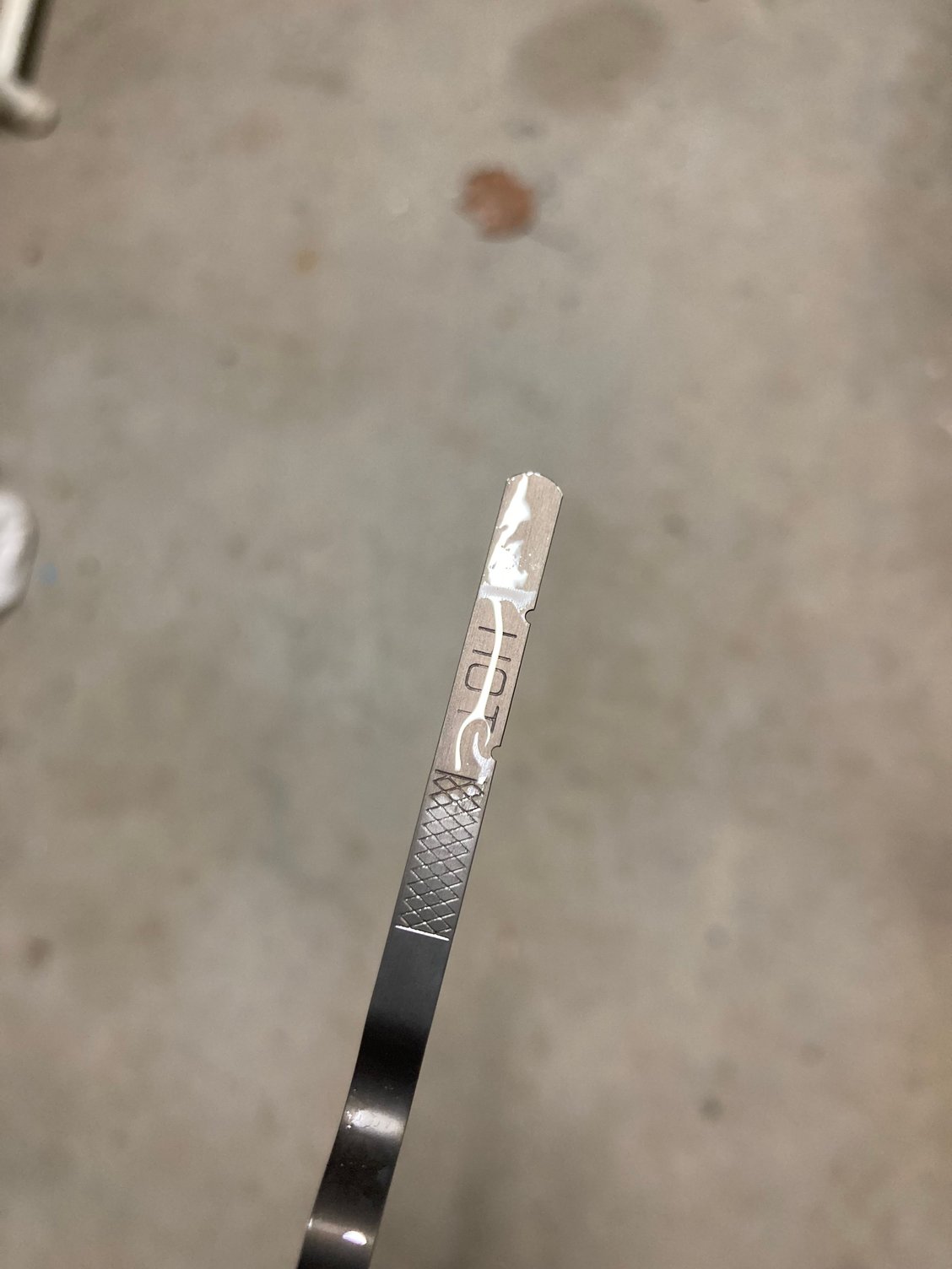

UPDATE!
The AT fluid measurement is very finicky. I removed about a quart of fluid last night. At first, I tried a siphon tool inserted through the dipstick sleeve, but the siphon tubing never reached fluid. I had to jack up the car and drain from the bottom. After doing so, my hot dipstick reading indicated a low fluid level:
I knew I had 1.25 quarts of new fluid still in the containers, so I felt safe draining 1.0 quarts of hot fluid.
My plan was to add fluid bit by bit until I reached the top of the HOT level on the dipstick. I started with 200 ML (or .25 quarts). Turns out, that was enough!

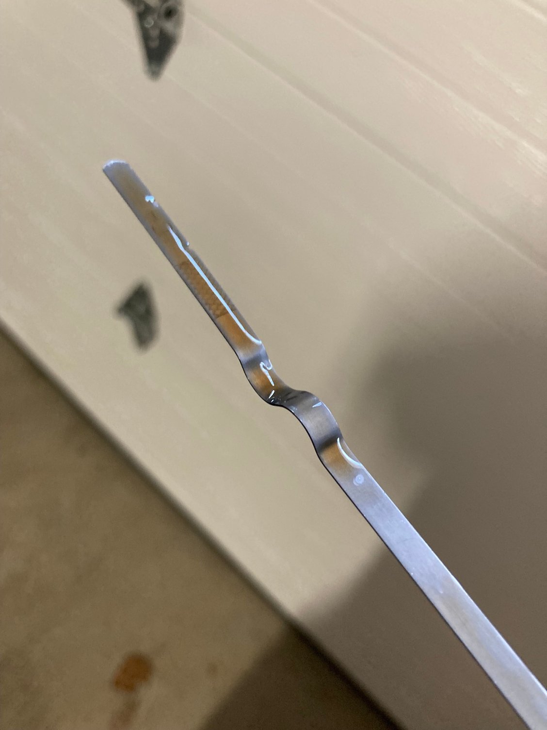

Check out this photo:
I waited for the car to cool down and took a cold reading. Again, the cold reading showed a shockingly high amount of fluid. (No photo of the cold reading.) The fluid went just past the curved part of the dipstick.

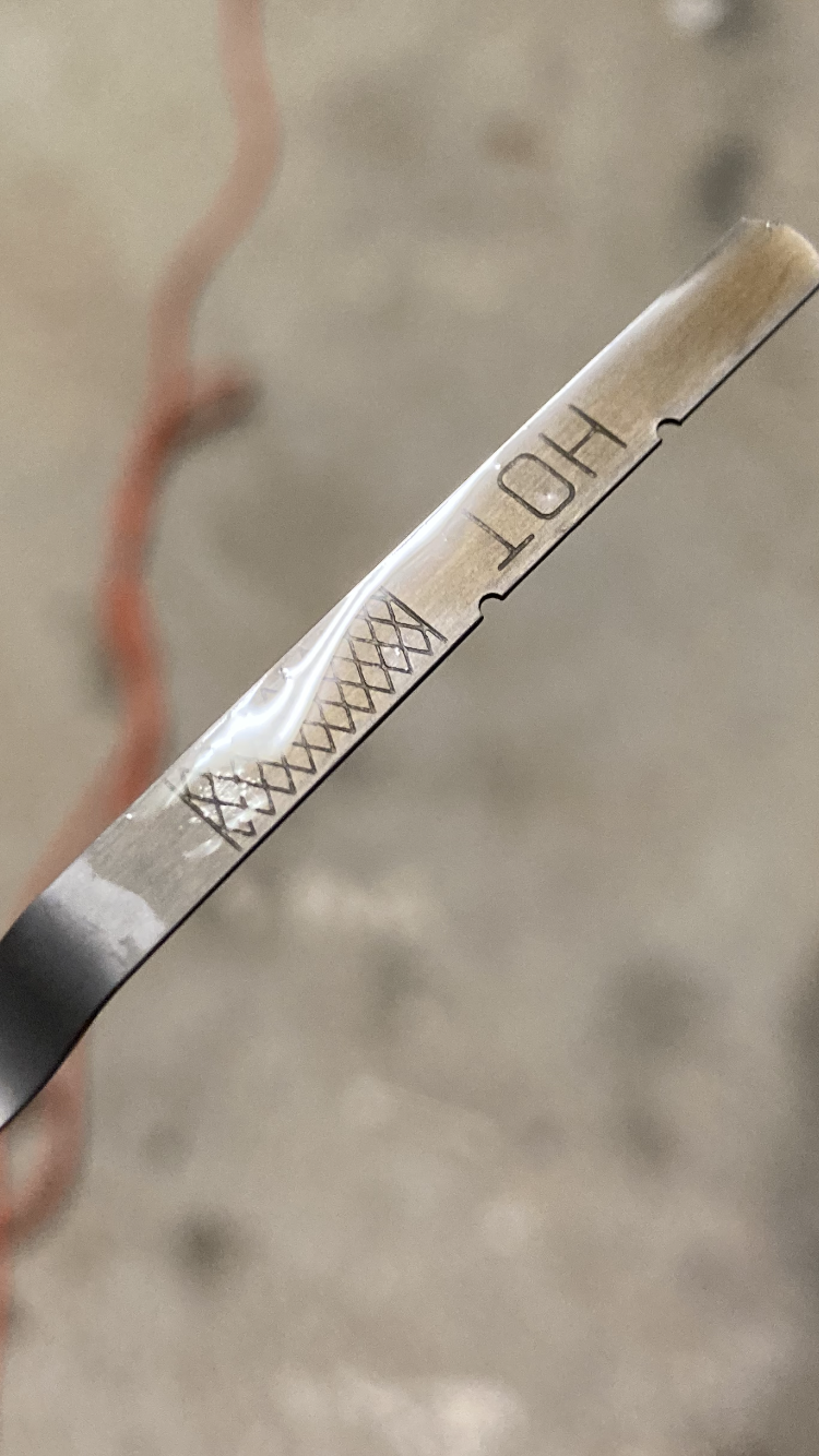

ANOTHER UPDATE:
I may have been misreading my dipstick. My dipstick has two notches with the word HOT in between. Then there is a hash marked area that I assumed to be for cold readings. However, the youtuber Motordyne G35 has a video indicating that there is a HOT side of the dipstick and a COLD side. The owner's manual doesn't address this, and I don't have a service manual. The dipstick shown in the service manual does not look like my dipstick.
Just to be safe, until I hear from one of you who knows, I'm going to add another .25 quarts (200 ml).

For future reference the distance between the top and bottom of the hashed mark area of a transmission dipstick is exactly 1 PINT of fluid. The distance between the top and bottom of the hashed mark on an engine oil dipstick is exactly 1 QUART of fluid.
