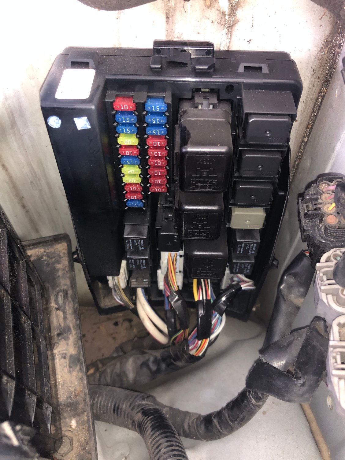

Thanks for everyones reply, cause im from australia im pretty sure it was on the right side of the drivers foot, so i opened the fusebox and just want to confirm if this is the correct fuse box?
https://imgur.com/DiNg1Sg
there is also a fuse box below my battery but nothing was labeled 'O2 sensor or 85' - so i went to the driver seat fuse box and the 4th one down on the right, did not have a fuse to start with as i opened it, after putting one in i am still getting the engine light. Is this a good chance that one of the sensors have shorted out?

Your fuse panel covers should be labeled. If it doesnt say O2 sensors then thats not it. Also, your IPDM as Cleric suggested. It is behind the battery...not in front of it.

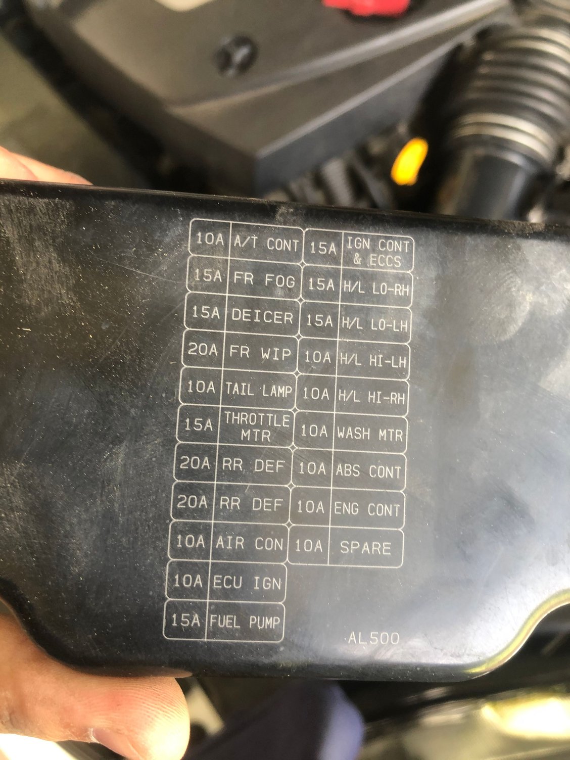

hey man thanks for your reply I got to the IPDM, doesn’t look like there’s anything about the O2 sensors, and all fuses are good
Located o2 sensor label on the driver side door cover, had a good 10 amp fuse in it, replaced it with a good 15 amp fuse, still have engine light, wow so annoying lol
EDIT : was looking at the above photo the wrong way, as i had it the right way - the o2 sensor didnt have any fuse in it... i put a 15 amp in and still engine light, (please note the engine light has only been on my car for about a month)

Wow...good thing it actually says O2 on there or u wouldve never found it lol.
I am not 100% sure but some stuff might require the engine light to be cleared with a scanner for it to turn off. I think the ECU might even reset it after its gone through a few cycles and tests good. I would definitely clear it with a scanner to be sure though.
