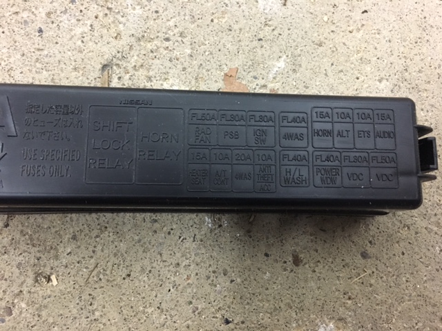

Old Aug 11, 2016 | 08:57 AM
mzancz's Avatar
Joined: Jul 2008
Posts: 6
No O2 fuse
I do have a fuse block next to the battery, and also next to the ebrake pedal. However none of these fuses are labeled O2, or anything that looks related? Pics attached. I haven't had a chance to look under the car yet to inspect the cables going to the O2 sensors.

Old Aug 15, 2016 | 12:10 PM
dookie's Avatar
Joined: Jun 2009
Posts: 154
i don't think there's a fuse for the 02. did you search the service manual?

From: CT
Guys, there are two fuse boxes in the battery compartment. The battery needs to be removed to access the one the OP needs, and yes, if you are tripping all four codes OP you probably popped the fuse. It has happened to me.
Old Aug 15, 2016 | 01:33 PM
mzancz's Avatar
Joined: Jul 2008
Posts: 6
Fuse box behind battery
Really, I didn't see anything in the service manual regarding this. I also didn't remember seeing anything back there when I replaced the battery but that was a few years back. If I remember there is not much space behind the battery before you are into the firewall, and that little plastic cover you remove to access the battery doesn't give you much room either. I can double check though. Do you have anything that shows this second fuse box?

Old Aug 16, 2016 | 11:04 AM
mzancz's Avatar
Joined: Jul 2008
Posts: 6
Found it
Sorry, I found the third fuse box location. I was able to just loosen the battery hold down bracket and slide the battery over a little after removing the windshield cowl cover.
The O2 fuse was not blown, but I replaced it with a spare 15a just to be safe. Same issue, so I will inspect the O2 sensor wires, and if they are good replace the two O2 sensors, then then hopefully that will be it.
