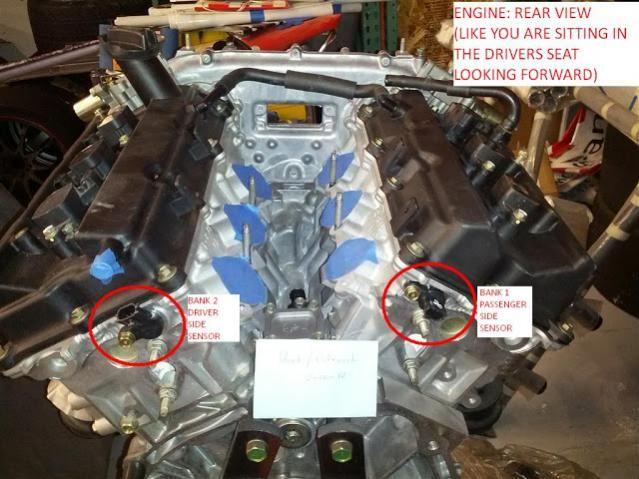

when I went to hollow out my cats, my car ran like **** after, not throwing any codes until later it threw a P0011 or P0021. When I say ran like ****, I basically mean that the car had a low idle start, little power, slow and slow as Hell (SERIOUSLY, it was SLOW that it was embarrassing. During this time, it progressively got worse to the point that full throttle would literally be the only way for me to drive the speed limit and not even that helped…), the car would pop randomly like I had a tune.
One day while I was driving the car, I was pulling out of my house on a hot start then the car idled 200 rpm, so I drove like a damn snail back to my house where the car died out from the low idle, Couldn’t break 7-10 Mph and could barely start, later the problem would be troubleshooted towards it not being a solenoid or any oil problem but a CrankShaft Position Sensor. Not sure why it threw a code for something different other than the Real thing, it basically gave my car a protection tune to go slower so I don’t break the car. I never had a problem with these but while you are at it, I heard the CamShaft Position Sensor could also cause these problems (Source: Other forums). Very important note: USE HITACHI OR OEM!!! Our cars are picky when it comes to these. They’re also fairly easy to change, one (Crankshaft Position Sensor) is right beneath the transmission, literally 3-5 minutes to change or look at (From jacking up the car as that takes about 2 mins), it’s right beneath the bell housing of the transmission (So damn easy to get to). The Camshaft ones are a bit tricky and are right behind the top end of the engine.
Not mine but someone else’s taken off of a g35/g37 forum
Some suggest to take off the plenum so it could be way easier which I didn’t do because I’m lazy but it is sooo hard to reach back there.
Do a little troubleshooting around there though. The only time I’ve ever had those problems was when I had the worst case scenario which was my crankshaft position sensor telling me that my flexplate is screwed. But still check those sensors just in case as it could be a bad sensor.
I do suggest waiting for more suggestions as I also believe this might not fix your problem, there are other problems out there that also include your symptoms so just give it a few for others to chime in…
