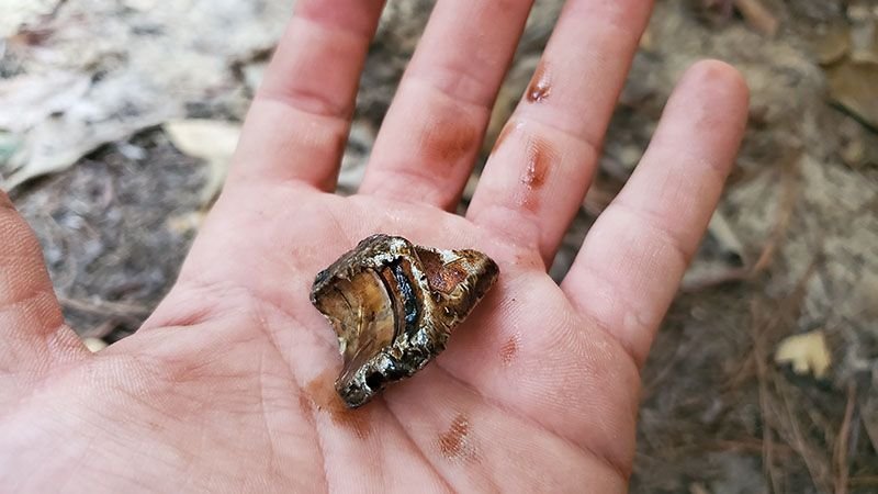

Bought an 05 G35 6MT with 49k original miles with a blown motor off a guy for $3000.
He told me "a rock hit the bottom of the engine"
I fished this out of the hole. Yeah, it's toast.
So in my infinite wisdom, I looked on ebay before I bought this and saw that there are plenty of reasonable JDMs out there for ~$1400. So I figure I can have this thing going for $5k all said and done. Good deal, right?

All you have is a broken lower oil pan, as long as the engine didn't run out of oil and eat bearings just put a new oil pan on it and call it good. No sense replacing the entire motor because of a cracked oil pan.
However I don't know how on earth a rock could get in at that angle to break the oil pan right there, far more likely it tossed a rod out of the block.

Ohh yeah that wasn't a rock, likely the engine tossed a rod.

I wouldn't blame the previous owner for thinking it was a rock though, he probably just didn't know and was upfront about the damage.
