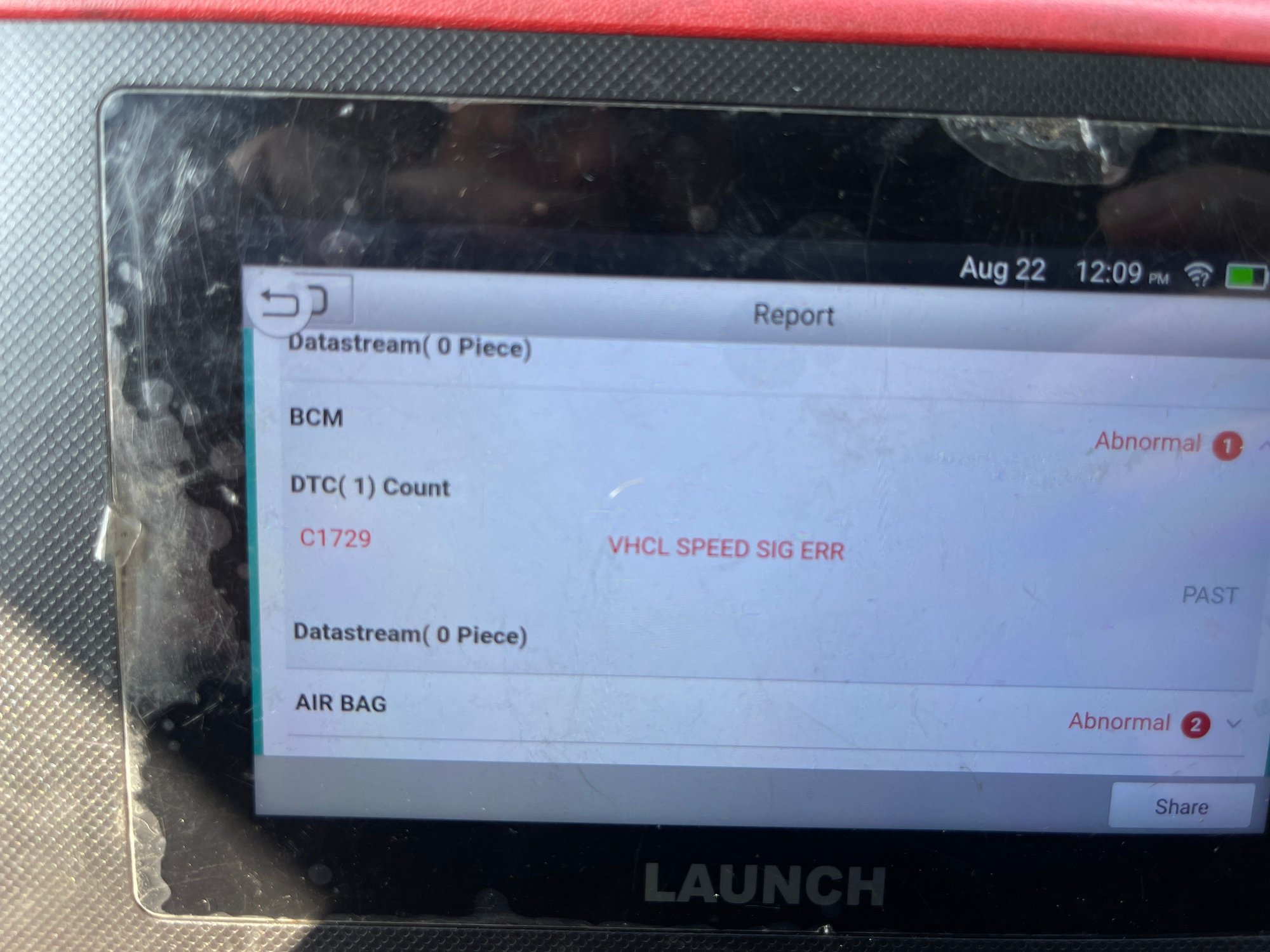

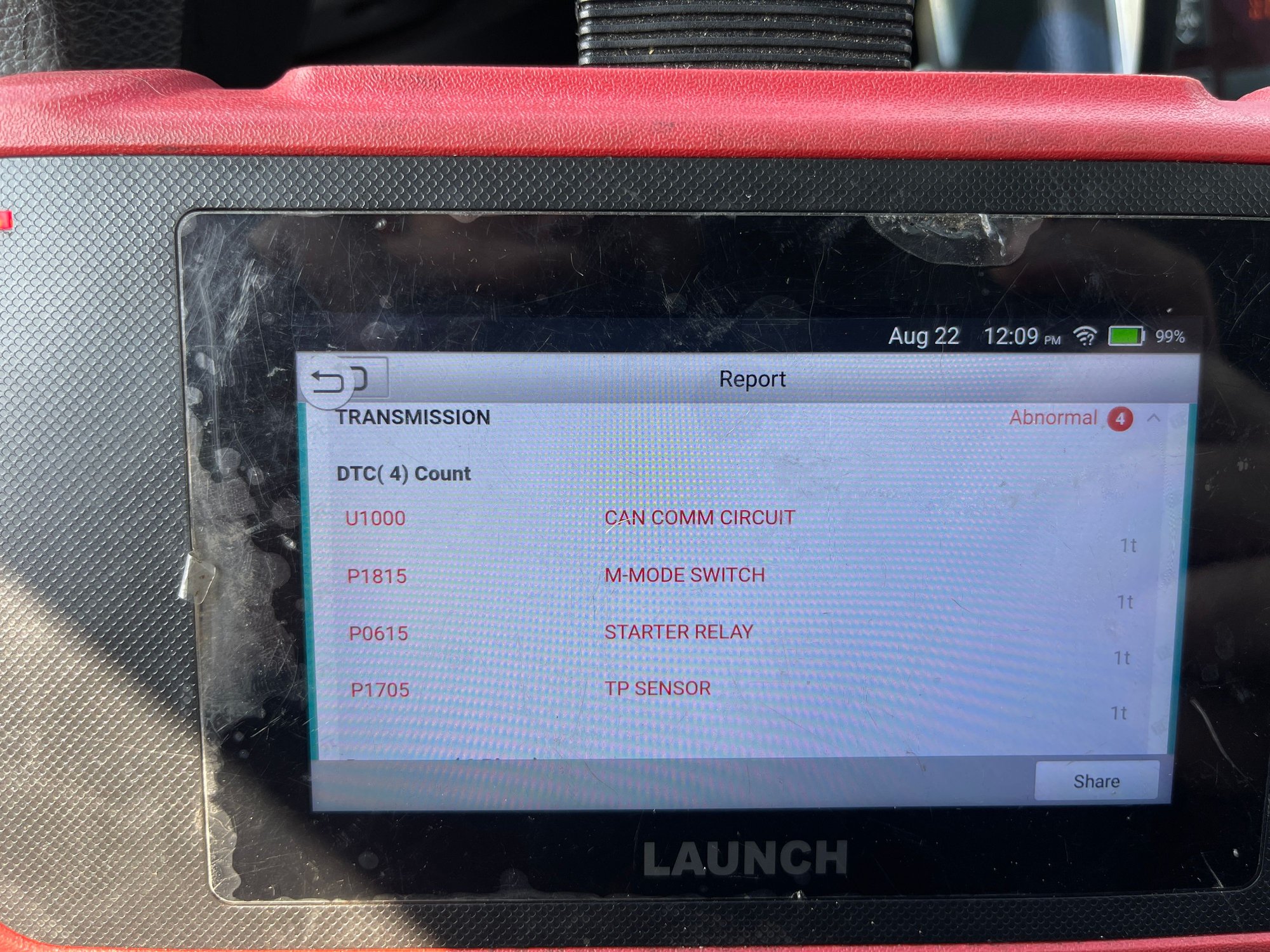

No crank no start no click no gear indicator on dash
car died out. Couldn’t get it to crank for 30 minutes of unplugged battery. Started up and it was stuck on a single gear and revved to the moon and took forever getting up to speed died out a block away from my house now it’s a no crank no start. Nothing. Replaced shifter assembly for m mode code
replaced ipdm for corrosion on the starter relay.
replaced starter
Also noticed there is no reverse lights when the selector is in r

Check to see if the ipdm behind the battery under the windshield passenger cowl is soaked with water

I did and there was corrosion on the starter relay so I ended up sourcing a used one and installed it

So you put on another IPDM yes?
What's the battery charge, have you put it on a charger to verify it's full?
