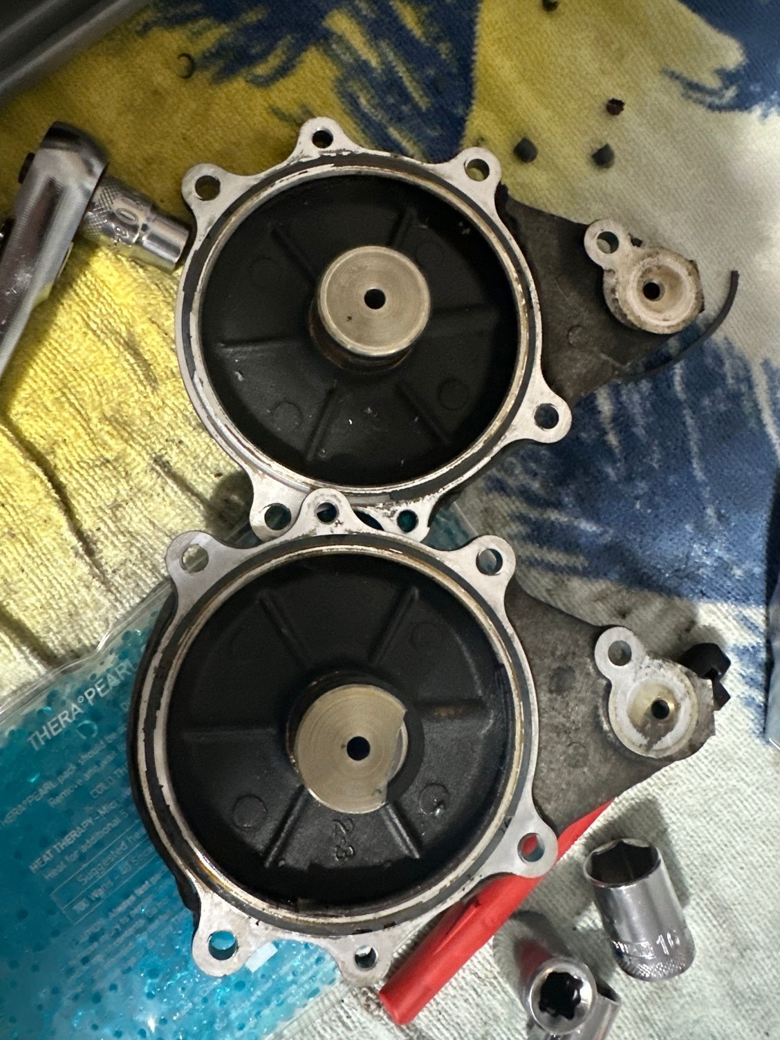

VCT cover was chipped.

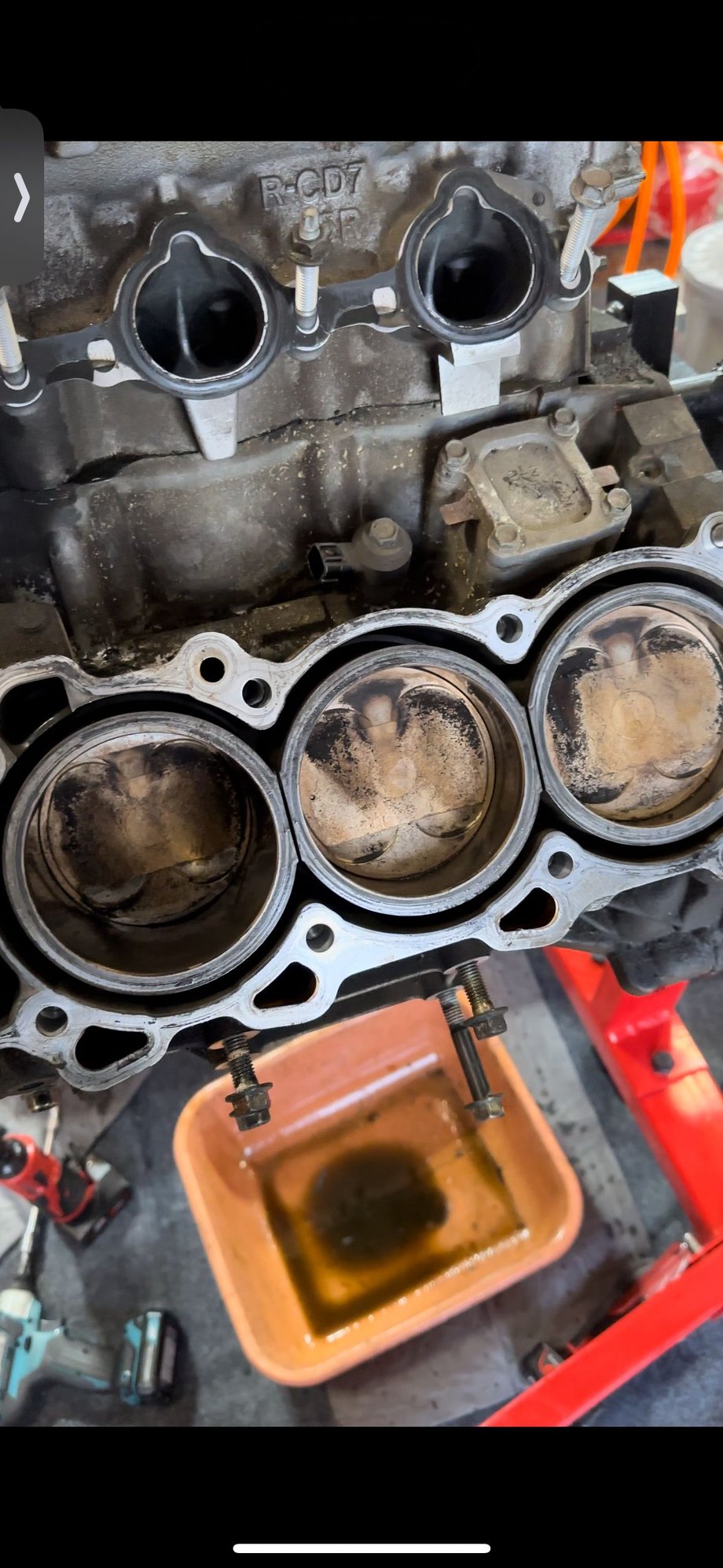

driver side did not have much carbon deposits on top of pistons.

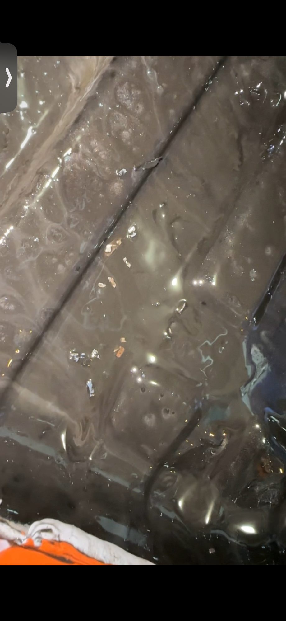

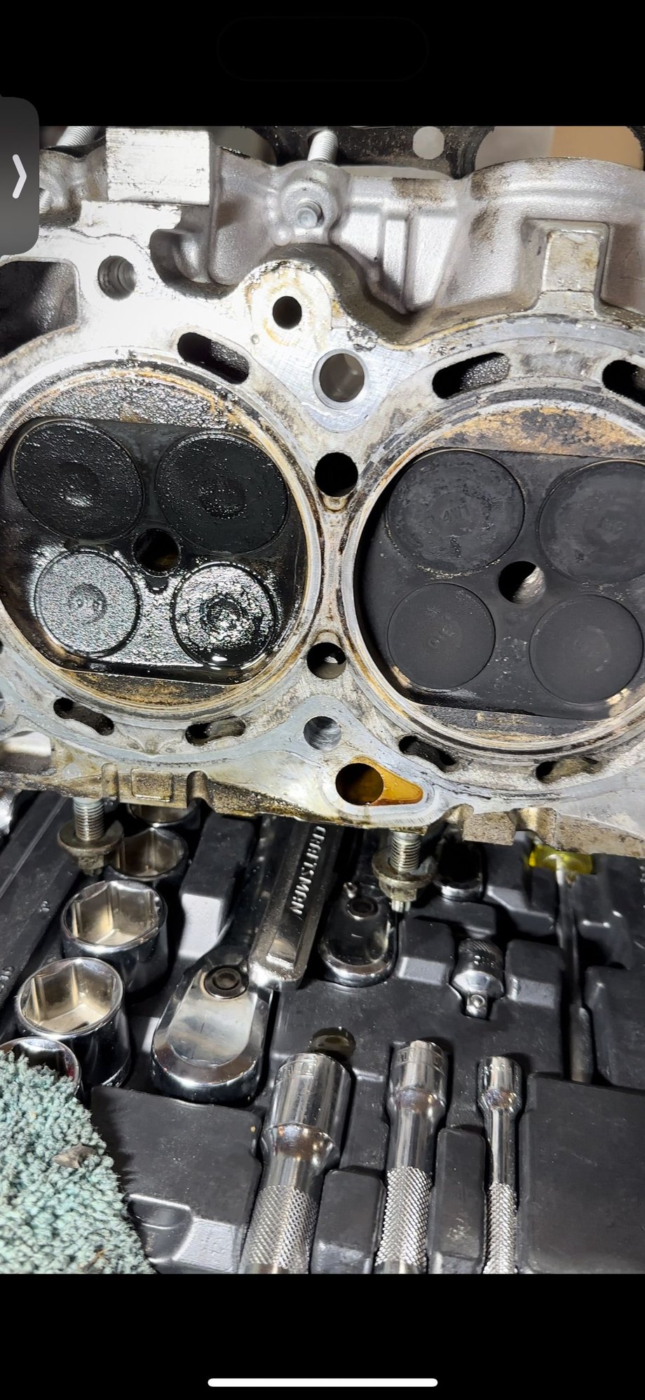

passenger side had carbon deposits on top of pistons and there was liquid on top of cylinder 1 and the valves were wet.
Coolant reservoir was pretty empty and smelt like gas and appeared to have a little oil.

Head of passenger side
Passenger side
Driver side
VCT covers
Oil pan
