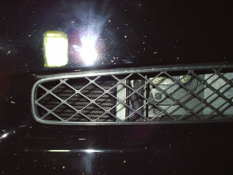

Here is the thread where I discuss the oil cooler. It is on the drivers side, blocks part of the radiator, but a small part. Depending on where your intercooler is, it may, or may not be able to be mounted there.
One pic to show you, as well, it is the drivers side, and you can see where the cooler is, on the left side of the picture. And my car is dirty right now, I know.

Thank you. I can't put mine where you have yours because the intercooler is there but I think there is room a little further to the driver's side. I will do some research and see where I can fit it.
You'll have to watch the hose length; make sure the hoses reach to where you want to mount it before you actually mount it. The way my hoses are routed, I couldn't mount it any further over, but if you route the hoses differently, you can get some more reach.
