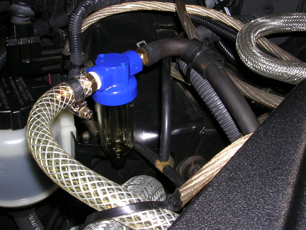

Andy what parts did you use to make the 90 deg bends on the connections...and did u get the compression fittings from home depot as well...thanks man

The brass fittings can either be had at Home Depot or Lowes. Initially, I was thinking about the compression type fittings. However, I just got the plain fittings for now, because I could not locate all of the other type of fittings.
In addition to the 2 original 1/4" threaded male to 3/8" barbed fittings, I also got 2 - 3/8" flip 90's and 2 - 3/8" x 1" long nutted nipples.
I took the 2 nutted nipple fittings and threaded one each into both sides of the Filter . . . Then I threaded the 2 - 90's onto the nipples . . . Then I threaded the 2 barbed fittings onto the 90's and secured all the threads to yield the sample pics posted on post number 46.

I like this set up better than my orig oil catch can as I can keep an eye on what is going on, the hoses are short, and it seals tight with no vacuum leaks.
I simply flipped the stock hose around and used a second piece of high pressure hose for the other end. Nice smooth lines with no 90's.

After having driven some moderately spirited 200 miles, today . . . It seems that placing those 2 plastic pieces (with the white filtering element completely removed) back into the filter assembly has yielded less oil caught. Have you noticed the same? The difference in oil trapped appears to be quite substantial between the 2 set-ups.

i agree with the filter it catches less oil...i guess its better without the filter

the filter was designed to pull at 4 microns the dirt out of the lines for air tools...so without the filter it should just catch all the oil that passes through and the filter is unnecessary.

Question: Is there anything unique about this particular catch-can you guys all bought other than it being a collector can with a "T" connector at the top?
I would like to explore looking for a larger (or rather wider) catch-can but want to check if there's anything specific to look for (construction material, or some design in the top "T" section that isn't easily seen from pictures, etc).
Old Jun 1, 2006 | 07:25 AM
  #90
g35rcr's Avatar
Joined: Dec 2005
Posts: 3,080
its easy for everyone to get and make...all the parts can be bought at home depot and an auto part store for 20 bucks...
