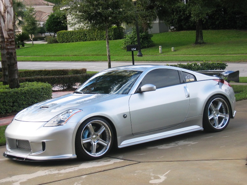

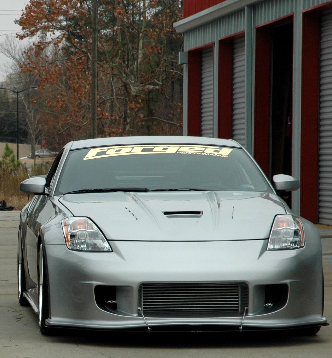

Some pics for those that have not seen.
Attached Thumbnails My engine build project-dsc_3934-v2.jpg   My engine build project-img_2696.jpg   My engine build project-dsc_38432.jpg
