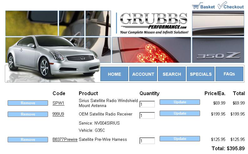

$125 for prewire harness??? that seem right????

If you need the prewire kit, get it from Everything G35 for only $85. That is a pain in the a$$ to install though because you'll have to remove your back seat and radio (with all the panels). It's not hard, but it's a lot to do.
Do you want the antenna inside or outside? Inside is easier.

If it is 2004 then you are prewired, otherwise, you'll need the prewire kit. Coupe VIN: 210827 & higher are prewired.
wes, you need to pull out the trunk mat and look by the amp for the white sat connector before you buy the harness...most of the 03s have the prewire harness allready.
As for install...if you are prewired it is simple, you can just DIY check it out here:
http://g-owners.com/article_read.asp?id=19
prewired instructions start at the bottom under "Satellite Tuner Installation". The top is how to put the harness in.
$250 for install is a rip off.
Old Dec 27, 2006 | 05:07 PM
dabomb's Avatar
FGC Central Florida BOD
Joined: Jan 2004
Posts: 6,947
From: Orlando, FL
Thanks Chris, I just verifiied the VIN# after u said that and mine is higher than the 210827 so I should already have it.
I guess I only need the tuner and antenna then...ROCK ON!
