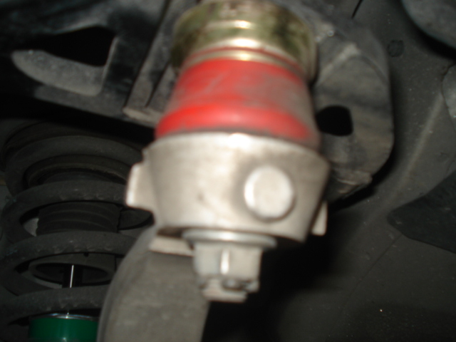

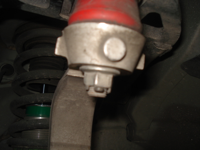

i was playing around today and took my front tire off. took a picture of my a-arm, came out a little blurry, but you can still see. looks like the nut just flares out at the top, but no washer in there. so do i need to put the washers i got anyway?

yes, put in the washers or resuse the stock nut. I used the stock nut bc i heard about that problem before SPC sent out the washers.
