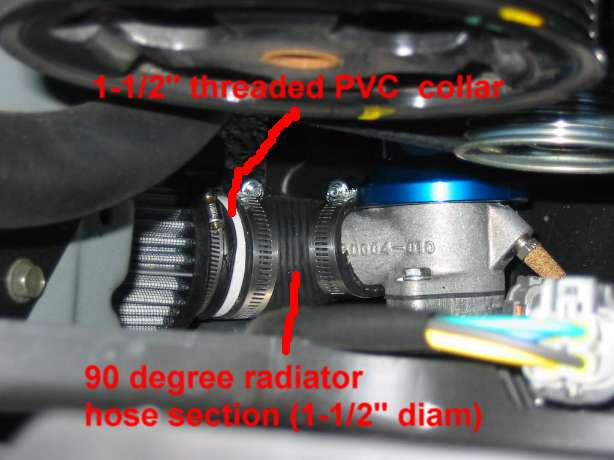

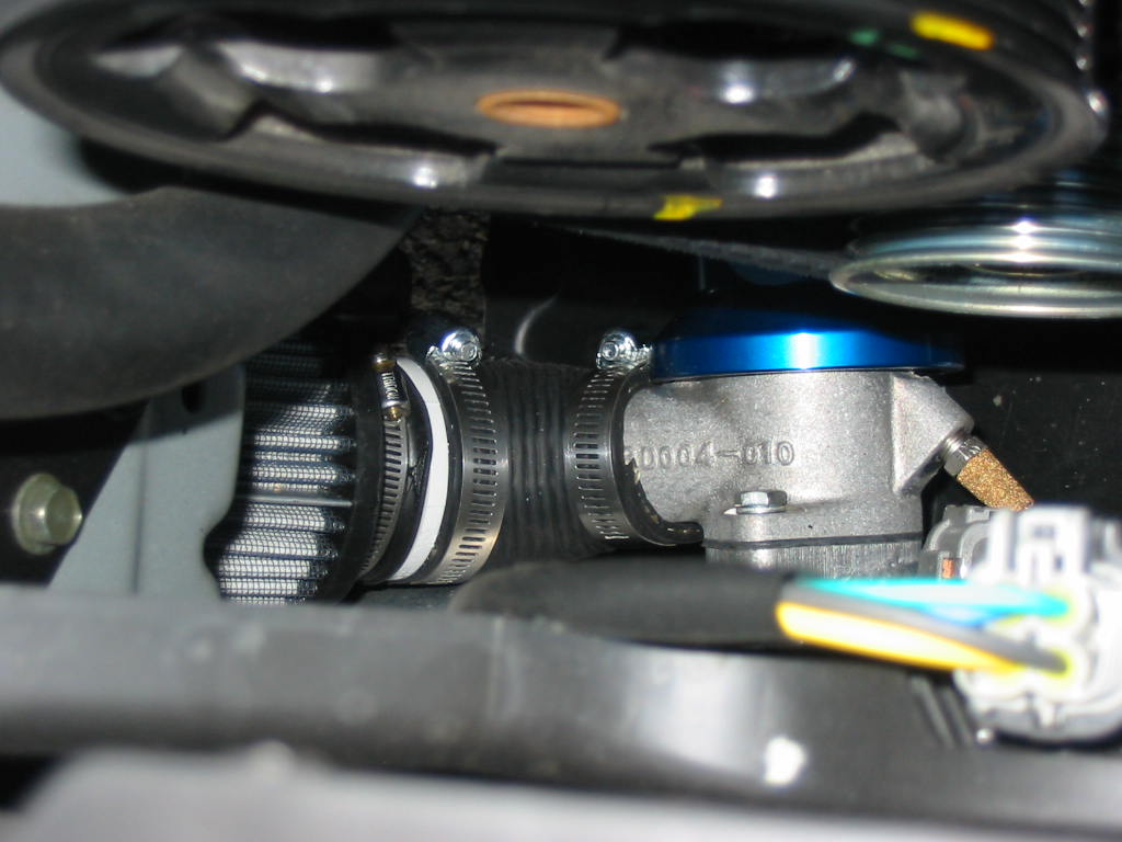

Loud Bov
BOV can be made a little quieter by adding small K&N style filter to it (sorry, I don't recall K&N part #). I also had that loud annoying whistle at constant speed and decel (when BOV was open bypassing the boost). I put a bottle brush inside the K&N to break up the air flow and it is a lot quieter now.

Old Aug 23, 2006 | 10:19 AM
kzanard's Avatar
Joined: Oct 2003
Posts: 291
From: Quincy, MA
I think you can find generic cone filter too. The BOV is blowing air out (not sucking air in) so the quality of the filter is not that important. It is solely for noise reasons. You can attach it directly to the BOV oval outlet. My space was a little tight for that so I fabbed a 90 degree elbow. Not sue if you can tell from these pics...
