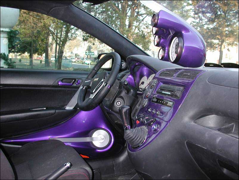

Man, you guys are gonna have my cabin looking like this guys soon enough. The purple ***** cluster by defi, accept no substitutes.

lol
