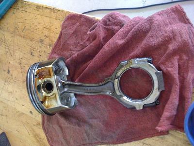

Hey guess what happened to me.

Jtram let me have that bent rod to make as a trophy for the next show.

Hell no, It's a murder weapon. My roommate did this to my car- He killed my motor and now it will kill him.

You shouldn't be bending rods at your desired power levels unless the tune is bad or something else goes horribly wrong. If you have a UTEC or equivilant that monitors knock all the way to redline along with boost cut and a decent tune, you should be good. Also add bigger injectors, pump, and possibly a FRS.
I thought I had a tune.
I didn't.
