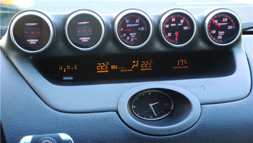

I vote A/F, Oil Press, Boost, Tranny Temp (Auto) or EGT (Manual). It's really not necessary to read water temp down to 1 degree resolution - the stock guage will tell you quite nicely if you are running hot or not.

Do your nexus gauges sometimes not turn on (one or more of them) if you start the car too fast? I've noticed mine have to be allowed to begin their 'init' sequence before starting the car or they never come on... been driving me nuts.

Simple fix... I just turn the key to "ON", wait for the Walbro to spin up and get pressure (1000, 2000) then turn the key to "Start". It works every time - No more trouble.

True, but it doesn't take 5+ seconds for the Walbro to spin up. That's how long you have to wait for the gauges to initialize properly before you start it. In fact, even the remote start causes the gauges to malfunction so I don't even use that anymore.
Even when they are working, you can't see them very well in bright light. If you're wearing sunglasses it's even worse, don't even bother looking at them.
No audible warning capability even though they make a loud beep when you turn them on.
They are loud as hell during init/shutdown.
No serial output for external data logging
I could go on....
POS gauges.
Especially given the ridiculous price tag, I would never, ever recommend these gauges to anyone.

I only switch "on", count 1 - 2, then go to start - I do not let the gauges go through the full startup before starting the car. Give that a shot. If you find the amber hard to see, try the white.
I did get a replacement gauge from Autometer once and the glass was much darker than my other gauges. I ended up not using that one because it was too dark. Yours may fall into that category - get Autometer to replace it.
