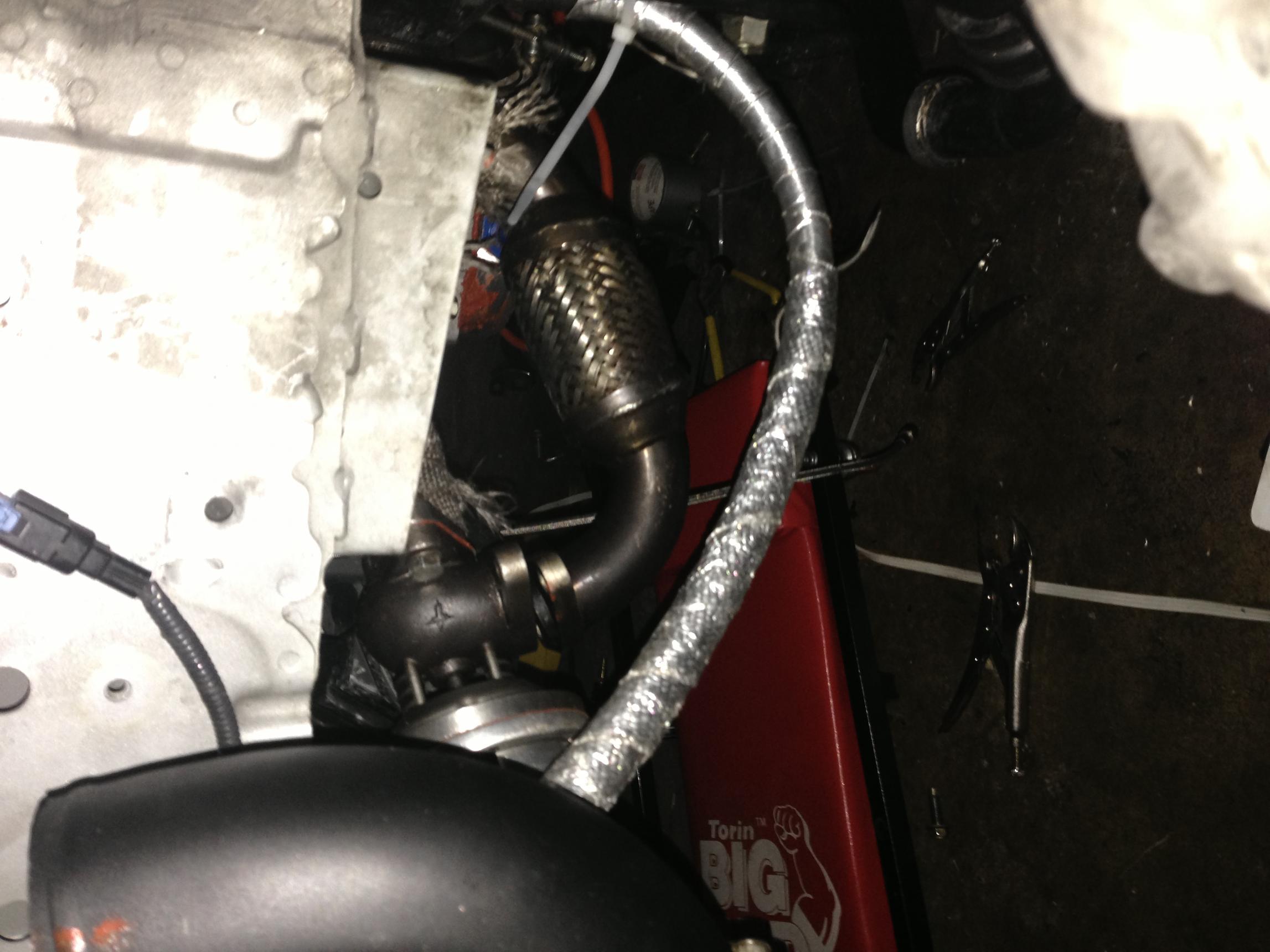

alright. so update. finally removed the stripped stud from the turbo housing. so thats done. i torched it pretty good and finally got it to spin.
turbo is in the car connected to oil pan and water lines. finally figured out the ic piping thanks to shemi so thats mapped out and will be done tomorrow. attached and ran my new ac line where i wanted it away from all hot pipes.
tomorrow i will run the two exhaust pipes i have left, tighten all v clamps, tighten all bolts, finish ic piping, refill fluids and hopefully get to start her up.
i also included some pictures of the progress as well. actually its only taking 1 for now
one thing i do work 12 hrs tomorrow so i might not have to much energy but hopefully acouple of monsters will do the job
