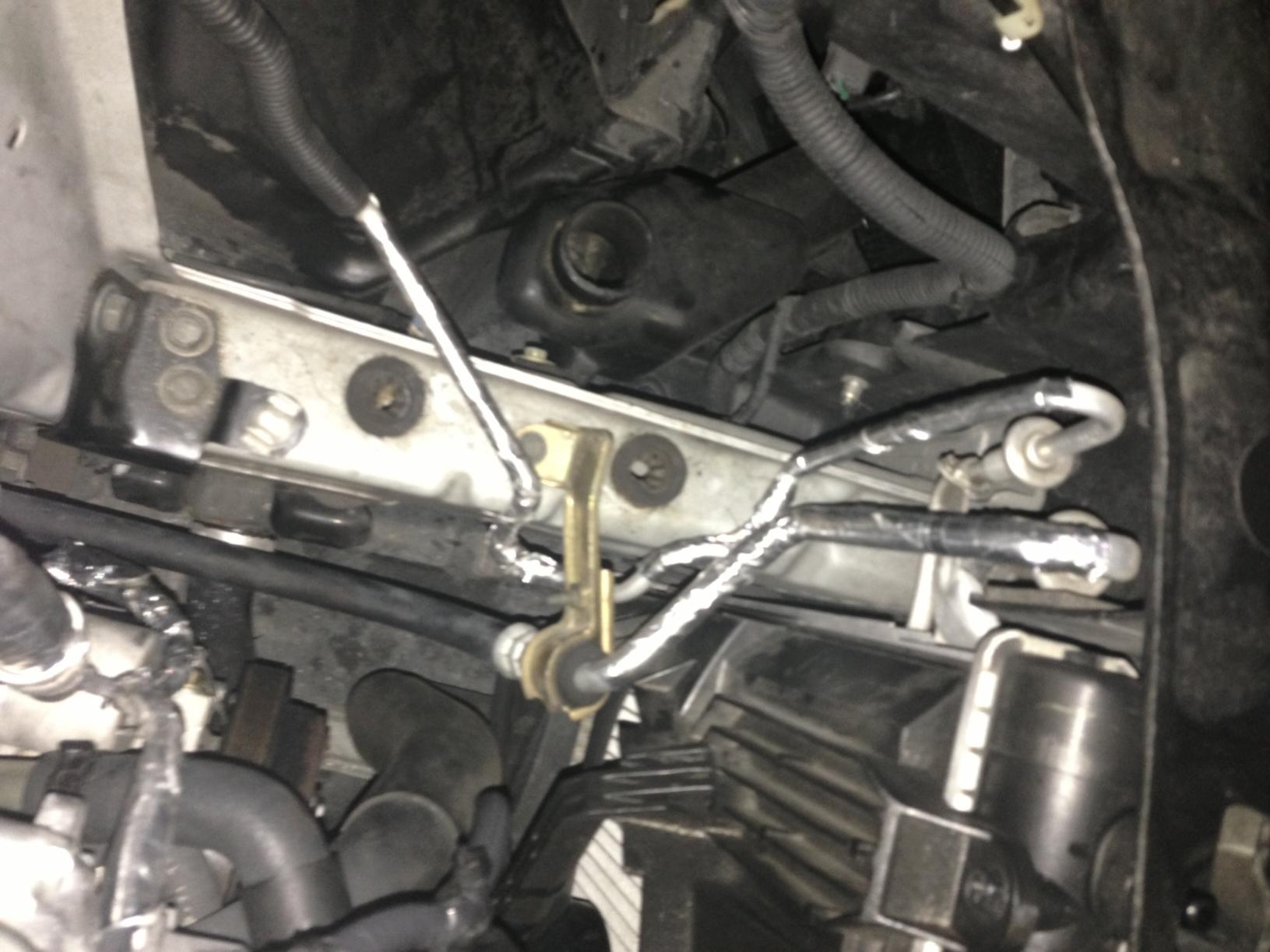

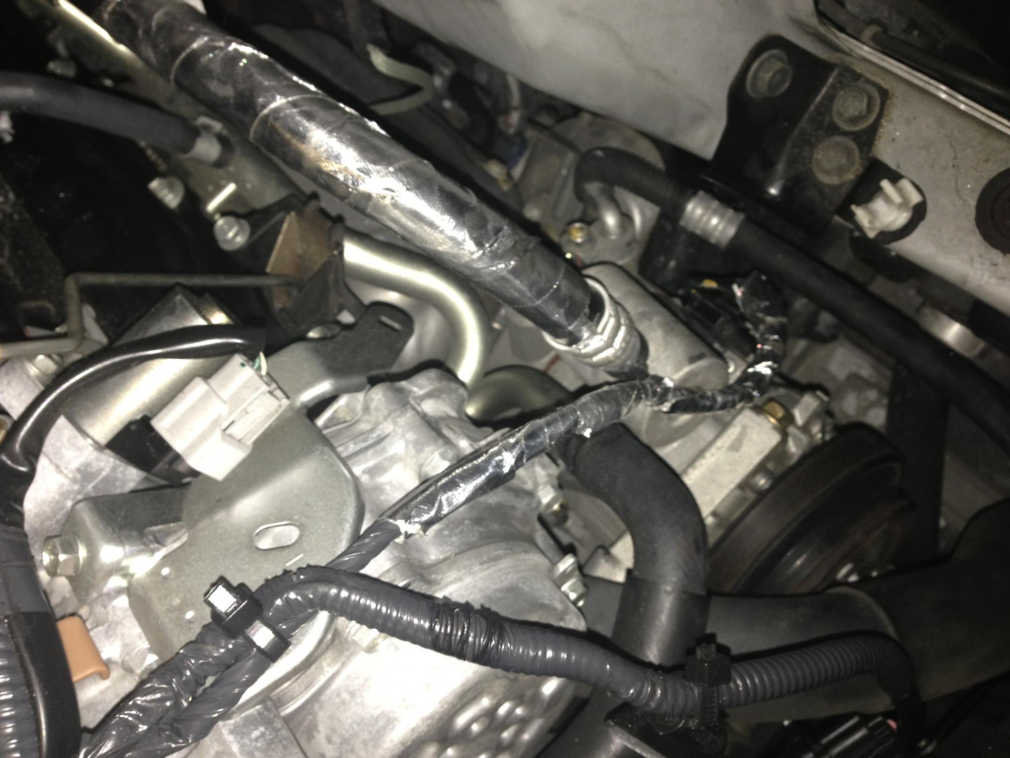

I picked up a used turbonetics kit with a brand new, newer turbonetics turbo water and oil cooled. I know that some people have had bad luck with this kit but 90 percent of them were caused by install errors. So I'm taking a few precautions to better insure my cars safety such as stainless steel braided clutch line, lots of heat wrap, Im going to water cool my turbo and most important I'm going to have stainless steel braided Teflon ac lines. They will be completely moved out of the way of the down pipe and turbo

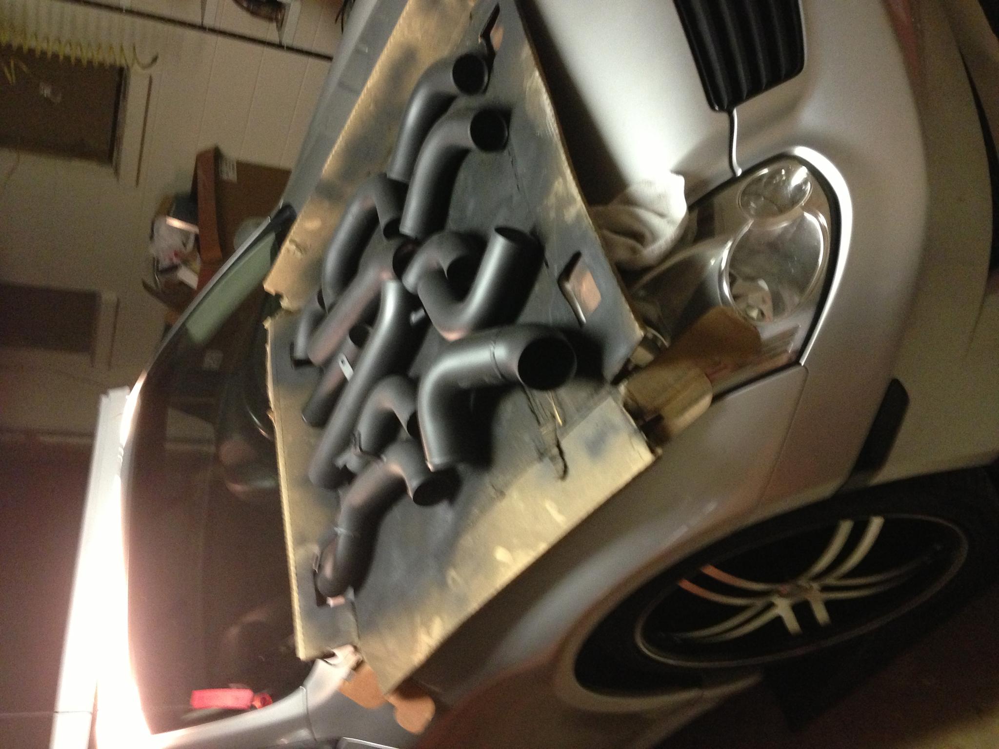

This is a list of my kit
1. The tn kit.*

9. Ac line relocation

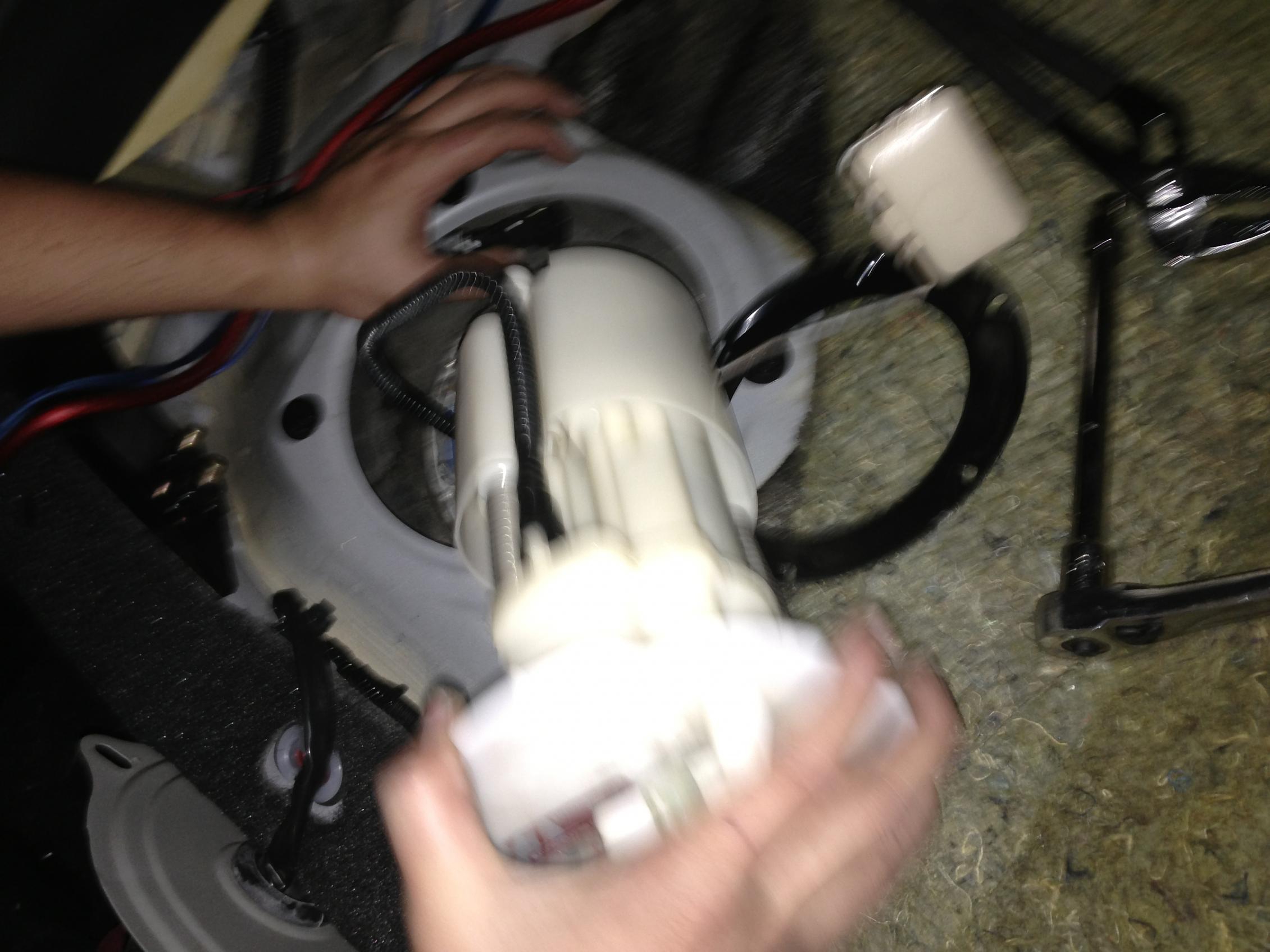

i work full time at a hospital and also go to school. i havent had much time to work on my car. yesterday finally got some time in and did my walbro and my spark plugs. to my surprise the person who owned the car had the same plugs in the car. and i had no oil problems at all, all the plugs were clean.
