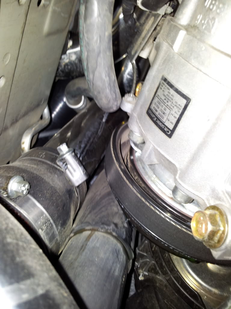

Sounds all too familiar
My lower radiator hose was rubbing on the ac compressor

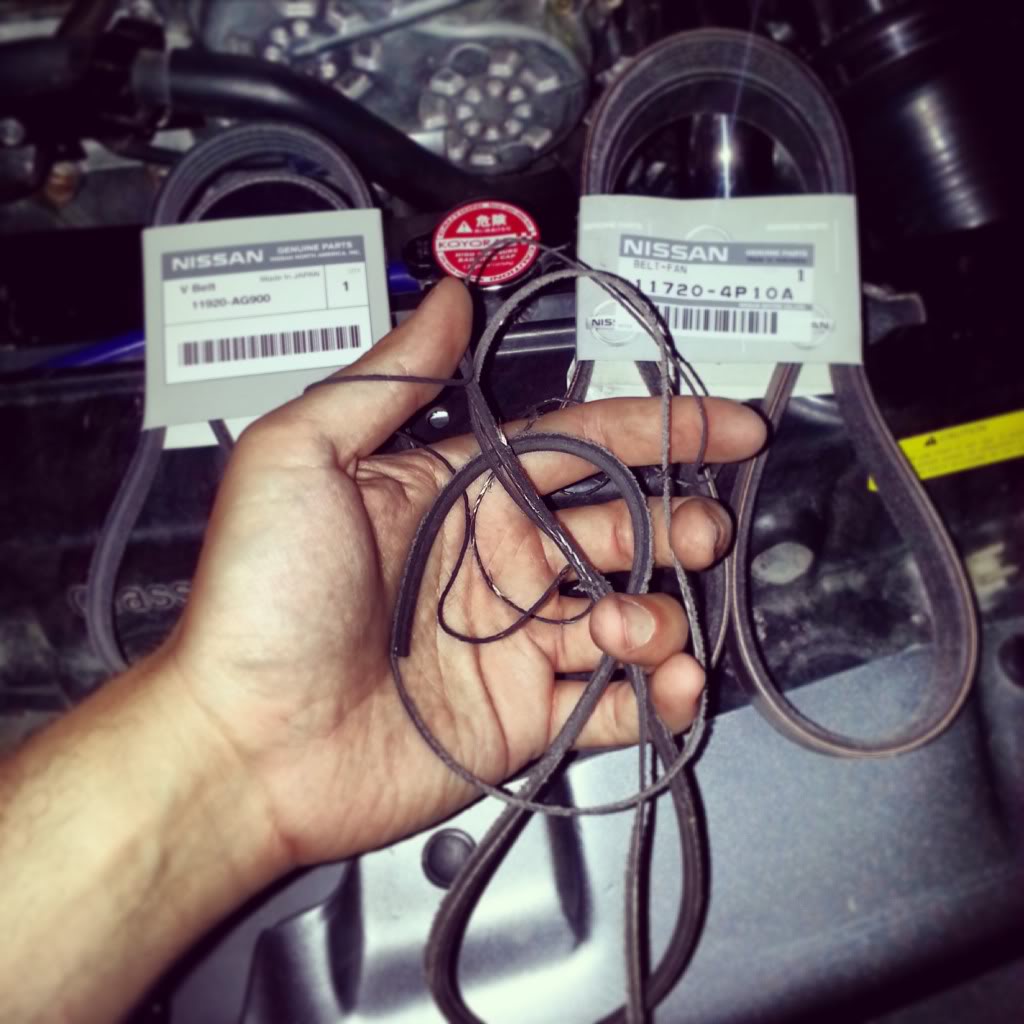

Replaced the hose and secured with zip tie as well. Except 3,000 miles later the belt got really frayed and needed to be replaced as well
