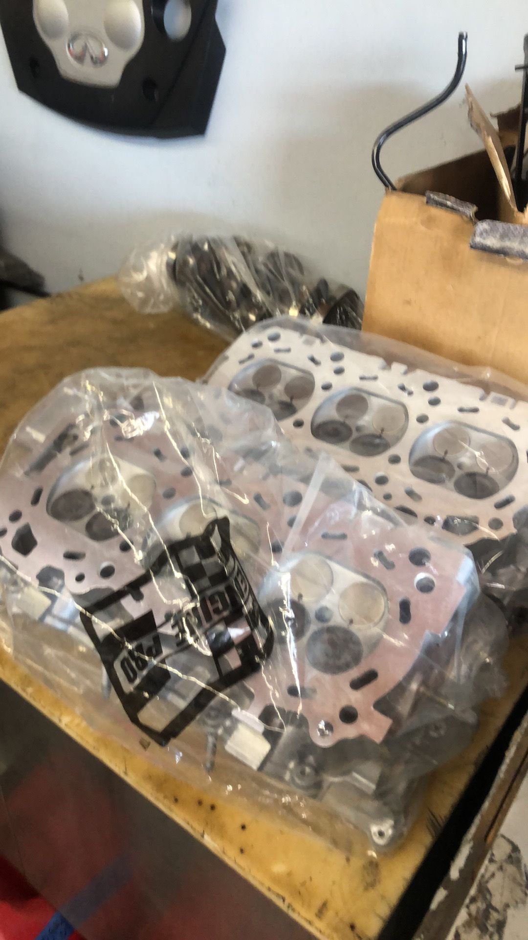

Fresh heads Angled, Honed, and polished.
