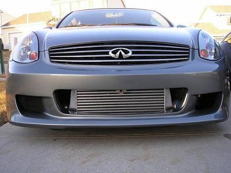

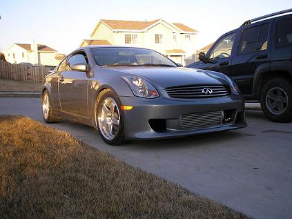

Here is a couple of pics of the IC and new bumper . Car is dirty as it hasnt been washed all winter
Attached Thumbnails Up and running  Woooo  Hooooo!-ic2.jpg   Up and running  Woooo  Hooooo!-car.jpg
Old Mar 11, 2006 | 08:11 PM
GXCLUSIV's Avatar
Joined: Jun 2004
Posts: 1,348
From: So.Cal
Like the look of that bumper. Seems it was designed for G's with FI. Looks mean with that IC showing.
