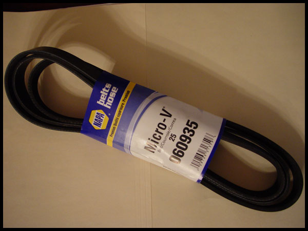

whats the part number on the other belt
Old Mar 2, 2006 | 04:29 PM
kzanard's Avatar
Joined: Oct 2003
Posts: 291
From: Quincy, MA
Do you mean the gates belt? I think Gates makes them for several auto parts stores. Here is a photo of the Napa version...
thanks
You are welcome. The Napa part # 060935 breaks down as follows (06 = 6 rib, 935 = 93.5"). This same part# was on a Goodyear belt I bought before as well.
