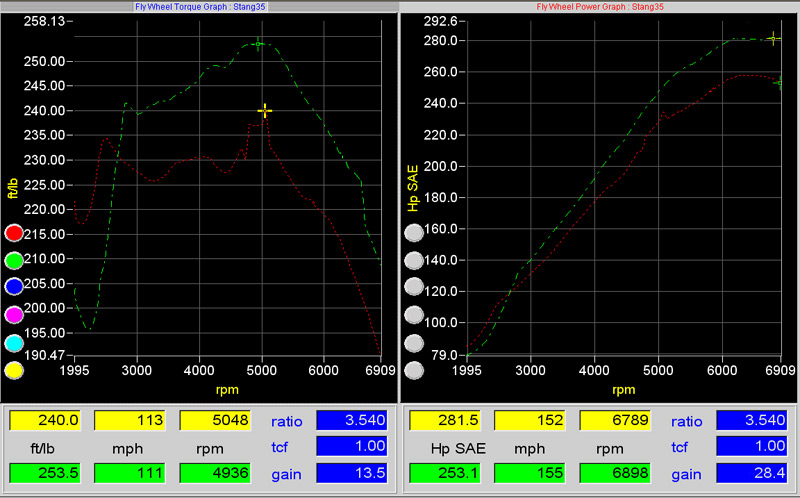

do you have a rev up? IMO a stillen s/c is not worth the money. You can get almost the same results ( a little less tq) with a UTEC and some bolts ons.
Look at this dyno on a 05 G35. 281.5whp and 253.1 tq with only a UTEC, and test pipes. You could still add an exhaust, UR or KNR pulley, a pop charger, plenum spacer, and possibly get another 10-15whp. This set up would be more realible than any FI system. Not only that it would cost about half the price of the Stillen and you could do most of the install yourself......UTEC is plug and play...test pipes easy, exhaust easy.....Pulley I would pay someone to do this. After that you just need to pay a tuner to custom tune your car....about $500.
G35
Stock=Red
Green=Mods: UTEC, Resonated Test Pipes 2.5 inch
