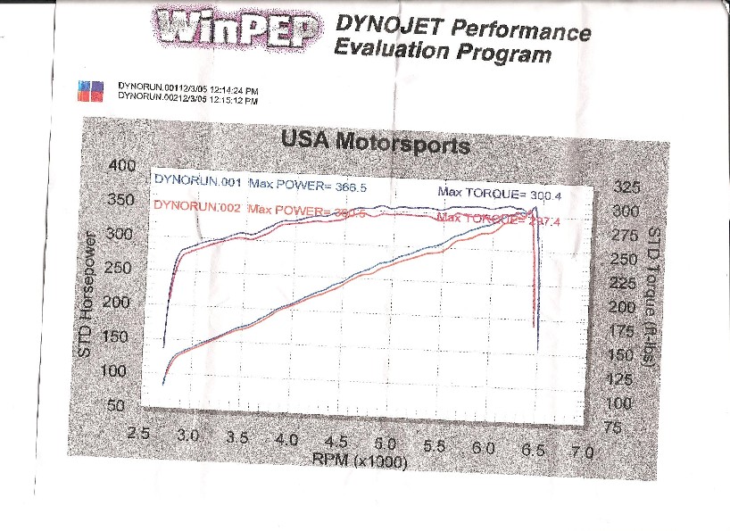

I posted this in the thread "Stillen vs Vortech. Pro's and Con's" and went unrefuted by anyone. Please take into consideration my setup is using the stock Vortech pulley and stock injectors. Additional mods that help power are a 1/2" plenum spacer, high flow cats and Injen TD exhaust.
Since this post I have been to the dragstrip and was only able to pull off a best 1/4 mile of 13.4 with a 60ft of 2.1. Without better traction I won't improve my 60 ft times which should be in the 1.8 - 1.9 area. By speed shifting I could be very close to 12's but I poosayfooted the shifts which loses valuable time. Supercharged G's with 5AT have been seen to put down significantly better times.
This is my opinion about torque "under the curve" with my car...
Originally Posted by BeerViper
Here are some thoughts from someone that drove a stock 6MT G for 2 years and then instantly upgraded to a Vortech S/C with Injen true dual exhaust with high flow cats...
The stock torque of the car at the wheels is about 225 lb/ft so driving the Vortech equipped G it is quite noticeable at any RPM that there is a definite increase in torque over stock. My car dyno'd at ~300 lb/ft (@5.7 psi peak torque) which by the dyno I attached you can see is reached at around 4800 RPM's and held all the way to redline. However you should notice that at 2800 RPM's there is already ~240 lb/ft so between 2800 - 4800 RPM's you are only increasing another ~60wtq.
As for the horsepower you can see how linearly it climbs to a peak of 366 whp (@5.7 psi) at around 6400 RPM's.
I also have dyno sheets from a dynapak dyno that negates any traction factors of the dynojet and gives you "chassis" power numbers. These graphs basically mirror the hp and tq curves seen in the dynojet with slightly different numbers.
In my opinion the Vortech setup has plenty of torque compared to stock and the "area under the curve" is very respectable. Additionally as others have said I can drive around with very little boost by keeping the RPM's low and therefore the car behaves like stock when considering fuel economy. The Vortech builds boost with RPM's whereas a Stillen twin-screw uses a blower with fixed displacement regardless of RPM.
My first attempt to track my Vortech G was last weekend but unfortunately Mother Nature didn't want to let that happen My rescheduled date for the track will be April 14 or 15 so I will let everyone know how this turns out.
I will be heading to the dragstrip this weekend to see how she does over the 1/4 mile (with the PIAA 19's). Hopefully within the next year I plan on getting a set of track tires/wheels and possibly some other upgrades along the way like intake and a bigger FMIC (and injectors may be a needed next step as well).
Attached Thumbnails Thinking of going Stillen S/C-jonsg_dyno366-300sm.jpg
