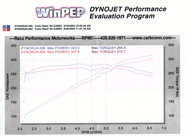

I dunno, I've been looking around for stillen dynos and keep getting people saying their stillen stage 3 with the 7 lb pulley got them 296whp and stage 2 got 284whp - on a dynojet I think. My NA car would be around 285whp on a dynojet, but it obviously wouldn't be as meaty down low
oh just found a 323whp stage III - here's a pic
Attached Thumbnails Thinking of going Stillen S/C-stillen-3.jpg

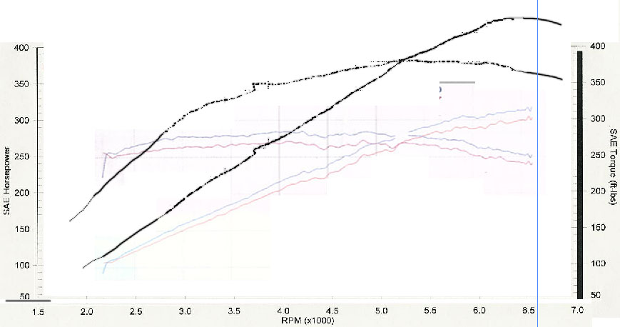

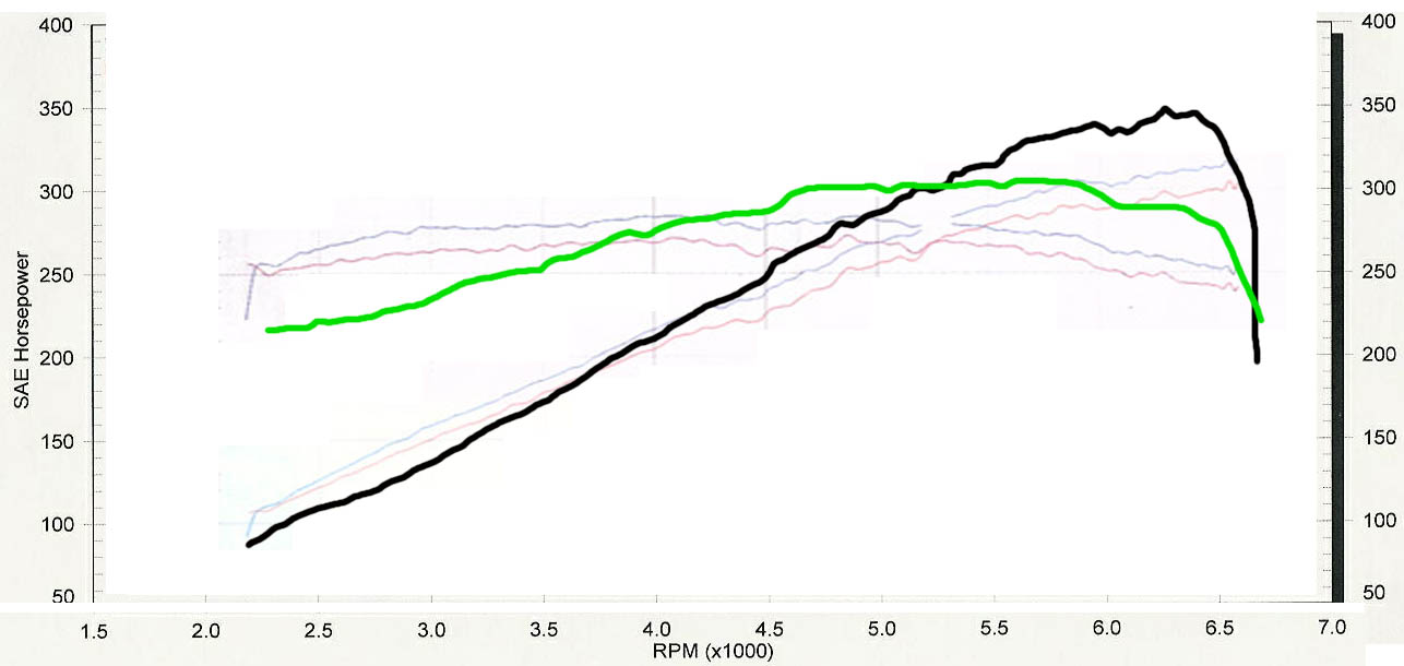

here's a couple graphs - I haven't calculated the area under 5500 rpms or the entire rpm area yet, but you can see what i'm talking about at least
323 whp stillen seems about what the average is these days
400 whp vortech is about what your average vortech makes these days
And then here's a 450whp vortech for comparison
I'd like to get a dyno of a 340-350whp stillen, but they're hard to come by - find me one and I'll compare them
for both these graphs the black is vortech and red/blue is stillen...I think red was stage 2 and blue was stage 3
Attached Thumbnails Thinking of going Stillen S/C-stillen_vs_vortech2.jpg   Thinking of going Stillen S/C-stillen_vs_vortech1.jpg

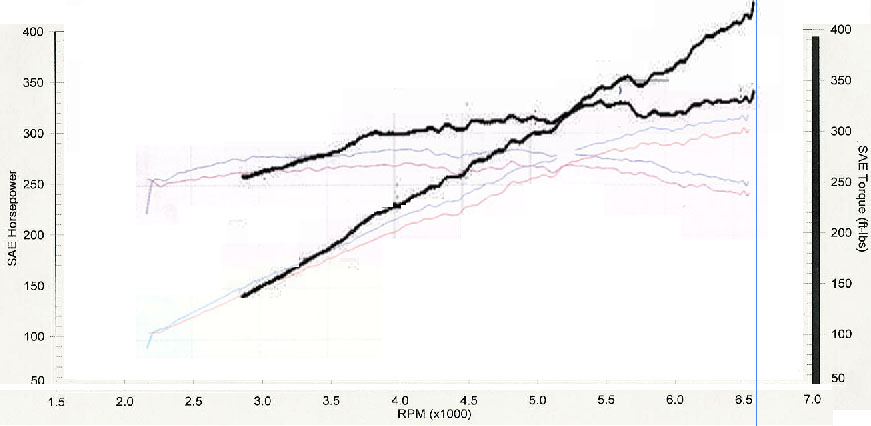

ok now here's a bone stock vortech vs the stillen stage 3
stillen is red/blue
and vortech is black/green - I traced over the graph and changed the color from the original dyno to clean it up cause it was a big mess of red and blue lines otherwise
Attached Thumbnails Thinking of going Stillen S/C-stillen_vs_vortech3.jpg

Those graphs are not even correctly aligned. Please give me the break down of each rpm 100. Then we will do mean average numbers. Until you do so, this discussion is useless.
