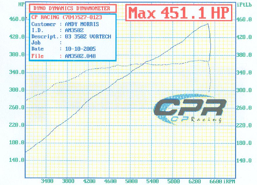

what do you want me to do - bring you some dyno charts?
it isn't all about hp and tq. - there's rotational mass, gearing, traction, curb weight, how fast the car transfers weight onto the rear tires. Those things don't show up on dyno charts. Well they can if you map out mph vs hp or tq, or hp/tq vs time, but typical charts show power vs rpm that people tune with and post up online
a lot of dynocharts don't even bother showing anything below 3k cause no one really cares about 2k
I'm not saying the vortech can have as much power in the 1-4k range, but has ways of more than making up for it and I'm sorry if you think that isn't true. I have nothing to gain by any of this conversation

here's one chart of a vortech
Attached Thumbnails Thinking of going Stillen S/C-finaltune_sm.jpg

Show me MEAN numbers. Right its not all about hp and tq peak #s, its all about the area under the curve and that is why the Stillen is one of the best SC to get.
LOL. Like I said, show me the mean numbers. Right you don't because you don't have that info.

Wow, definitely a non-stock pulley Vortech making more power than Vortech advertises.

yeah....that's a 2.87 pulley - not too horrible huh?
as far as mean numbers - what are we comparing? Seriously I can calculate mean area under the curve and am more than happy to show you how I do it. I can do hp and tq seperately and also average them together.
But we need to first decide on what we're comparing cause a 340whp stillen vs a 340whp vortech is a lame comparison caues no one runs 340whp on a vortech, everyone runs 370-450whp these days - and 340whp on a stillen is pretty high as is.
do you want me to go off the chart in the SPEED article? It makes 320whp at 6560rpm and 306 tq at 3930 rpm
so what are we comparing? Get me some graphs of a stillen and I'll calculate some % numbers of the area

Even then I am willing to bet a Stage 4 Stillen vs a pullied Vortech the Stillen makes more power under 5500 still. But even Stage 4 helps the Stillen where 6k~ would be higher. I rather and any racer would rather have a flat torque curve instead of a linear.
Give me a stock Vortech Dyno that has the break down per 100 rpms increments. I have one for Stillens Stage2 already and we can go from there. I have the extra spreadsheet that will do the work for me.
