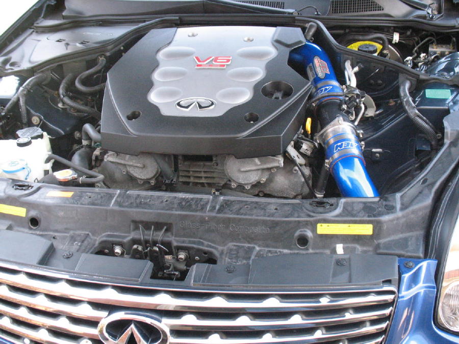

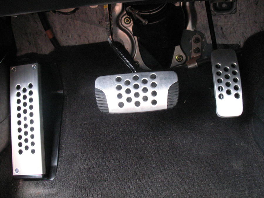

Installed OE sport pedals .
Installed AEM CAI .
Washed and waxed the G .
Put my Boat in the water .
What a great day !

nice mods
i heard those sport pedals are a PITA to install.
were they?

thanks
the dead pedal was easy . took a couple minutes to figure out how to unsnap the old gas pedal . the brake pedal was the hardest . had to soften it up with a heat gun to make it pliable enough to stretch it over the pedal mounting plate. a straight edged screwdriver helped pry the rubber around the mount.

Some people have big problems and some don't. Took me all of 15 minutes to get mine on. Like mentioned above heat up the brake pedal (I used boiling water) to soften it and then start at the top edge , do the sides and finish with the bottom.

There's an old trick that people use putting rear windows in trucks, which is to put a thin rope (parachute cord works best) in the groove of the rubber, then just pull the rope perpendicular to the lip while pushing. This should translate to the installation of the pedals quite readily.
http://www.fordmuscle.com/blog/insta...k-glass/112212
Gives you an idea of what you can do to make it a bit easier.
