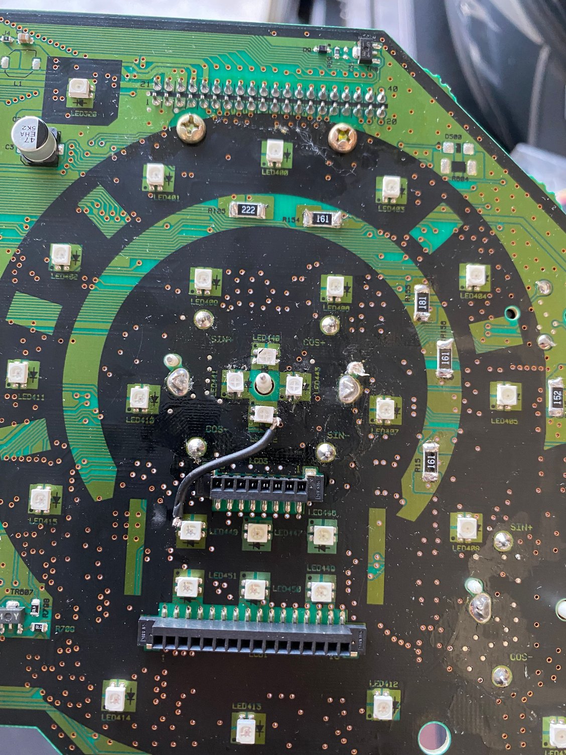

There are 6 LEDs behind the odometer LCD screen that light it up. Disregard the small electrical wire. I was just experimenting. But sometimes a new LED wont fix it because the issue will be a bad circuit on the board itself
yeah if there are 6 leds and all of them are out it’s definitely some other single point they all have in common. Did you power yours outside the car? Wondering how hard that would be to figure out because I’d prefer to know it was working before putting it back in. And not have to trial and error 10 times to finally find the spot that fixes it.
oh I guess the leds could be in series so it could be one crap connection on any one of them. Or one bad one in the series string like your Christmas tree lights.
