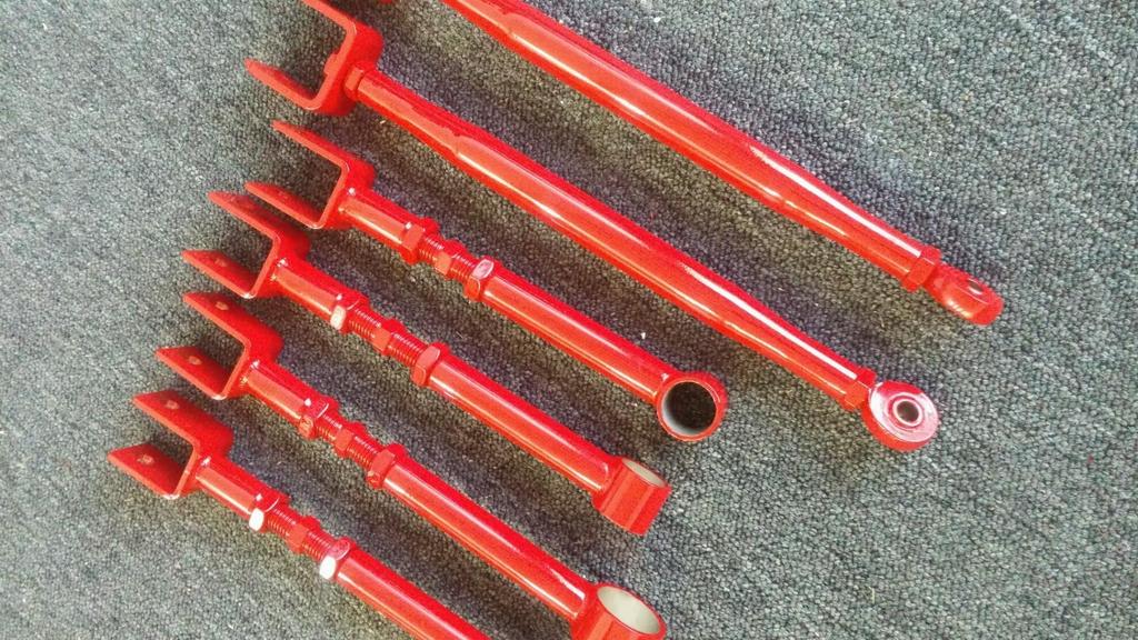

Can't believe ive waited 3 weeks for powdercoated parts, only to find a 3 year old could have done a better job. FML.Name:  PART_1429571553198_0420151910_zps9vqq0rzo.jpg

What's Wong with it?? Orange peel??

The arms were coated as one piece. Not disassembled. Also, the fins were supposed to be exposed. Not just the ends. Ugh.

That's messed up.. You won't be able to adjust the arms with it in the threads..

He told me to "break lose" the nuts etc. Im sitting here like whaaaaaa. And how do you do that when the threads are covered and the nuts are now part of the fn covered ends, without damaging the powder.
He also did my knuckles but no pics yet. I also asked him to leave all the machined areas bare. But I can only assume he fcked that up too.

I was looking at that but thought it was spray paint or something. How the hell he manage to not coat the insides of the bushing end?
Moral of the story always take in the bare minimum, it's lest for a shop to screw up. In this case you could have sent just everything except the fastening hardware.
He coated the danm spherical bushings too. Obviously no automotive experience.

You don't want to coat the insides where the bushings go.. It will make it extremely difficult to press the bushings in with the added material in them..

I told him not to spray the bushing areas. Guess he did that one thing right.
He better not charge me to fix this BS.

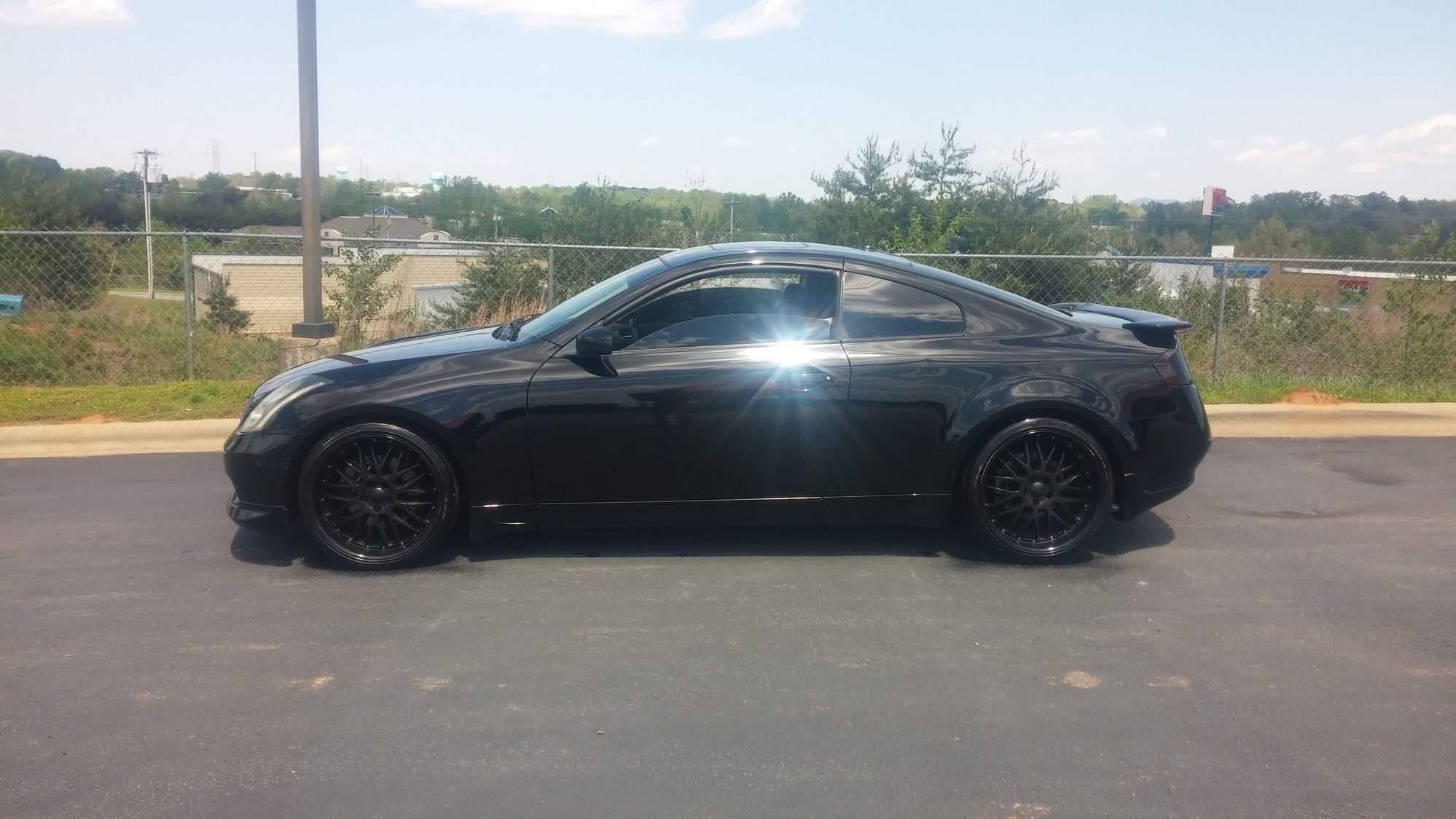

I tried that Turtle wax wet & dry spray today. It looks a lot better than before. What you guys think? Also I'll be ordering my coilovers later today.

From: Chicago
oOOooooOOoooOOoooOO glossy!
Front needs a little moar low and you'll be set.

Posts: 111
From: north carolina
I'm looking to go with a 2" to 2 1/2 drop. while still having a comfortable ride on a daily. I'll have to ditch the rubber band tires though
