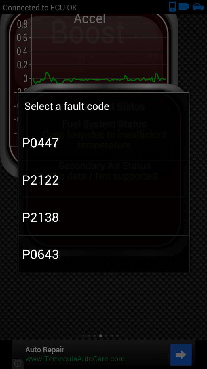

I had a P0447 code showing for a month or so but no problems. Then all of a sudden this after the resonator swap. Now I'm getting more codes along with these messages on myobd ii scanner.
For P0447 Check your evaporator canister for control valve operation
For P2122 try cleaning your TPS sensor and connector. Make sure there is no moisture or corrosion (probable cause faulty sensor)
For P2138 do the same for the accelerator pedal position sensor (probable cause faulty sensor)
and P0643 - Faulty Engine Control Module (ECM)
- ECM harness is open or shorted
- ECM circuit poor electrical connection
- Shorted sensor on 5 volt circuit
All issues could be related to a bad ECM
