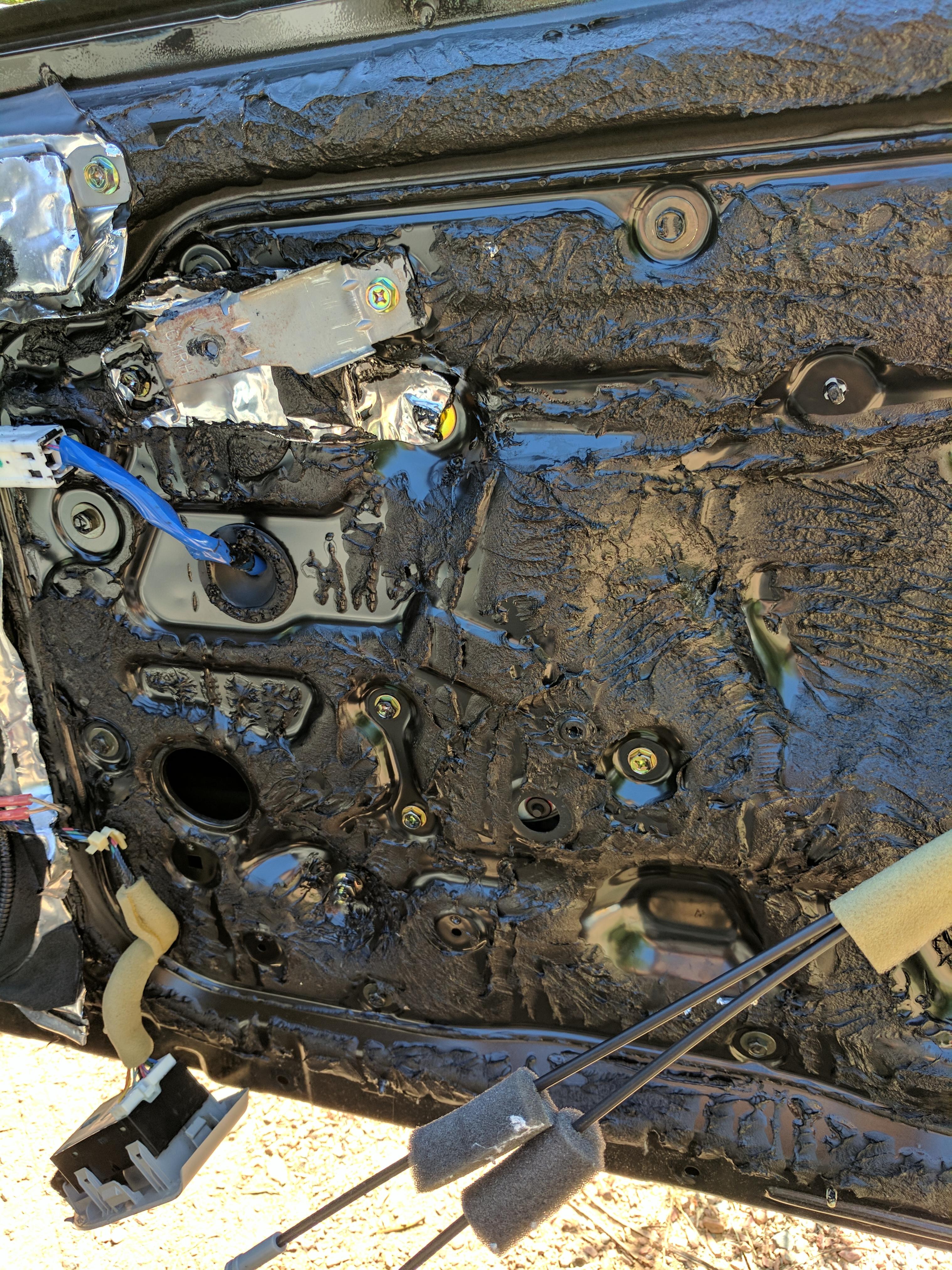

Looking at it further it doesn't seem bad. I was thinking of removing the glass and all that stuff that's not really necessary. I had an audio shop install dynamat when they were doing my sound system thinking it was going IN the door like it should. First time I had my panel off I saw they just layered it all over the whole metal assembly covering every bolt. I pray my window motor stays healthy

You should be praying they didn't use mastic adhesive to secure the dynamat, let me dig up some photos of the natural disaster the previous owner left for me...
It's quiet and there are NO RATTLES WHATSOEVER but there was a price to be paid... indeed...

Screw that. Car is for sale once my window motor fails lol. They didn't use dynamat, it was the same product by stinger. I thought dynamat just peels and sticks? But in the florida heat I figured that's what mine would end up like in your pics. I would just attempt to cut around each screw to expose them.

Well the mastic **** all over the door panel was for vibration dampening to stop rattle from the big stereo, they put dynamat over the top of it and I peeled it all off and scrubbed the door panel with acetone for hours to get that crap all off.
