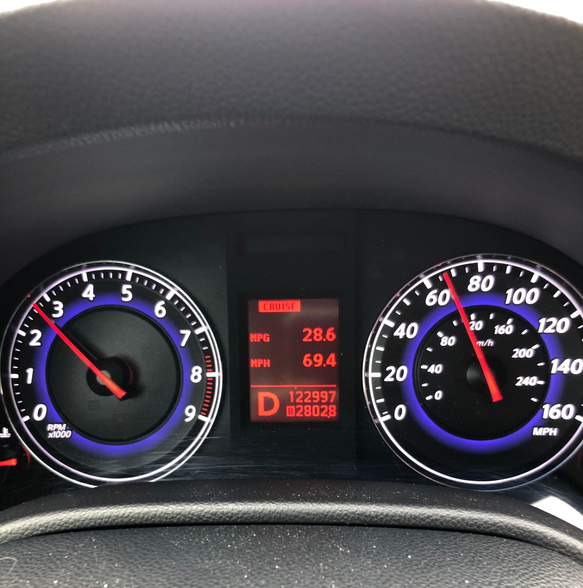

On the topic of fuel economy, here's two pictures from a road trip I made today. The two pictures are from ~10 miles apart showing it wasn't a case of going downhill or coasting in order to get "high" (for a G35 !) gas mileage.

Keeping in mind that's a totally different engine in your car.

EPA ratings for the OP's car is 16/23 while mine is 17/23. As far as fuel economy goes, there's no real difference (1 mpg city ?).
