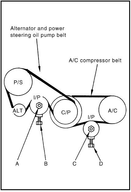

That’s correct…mine’s an 07 6MT, good catch do you have a diagram by any chance ? Here’s the only one I could find, but does not correspond to what the setup that you mentioned (2 Idler pulleys)

Yeah that one you posted is for the VQ35HR engine, here's the one for your DE engine. Everything is accessible from under the car, just remove the bolts for the engine lower cover.
You can technically do it all from the top of the engine if you have small enough arms but I always end up with pretty substantial abrasions so I don't recommend it unless there's just no other way.

So the two at the bottom of the diagram labeled I/P(A&C) are actually tensioner’s, not idler pulleys ??

Yes and they drew the adjustment screw on those two as well.
