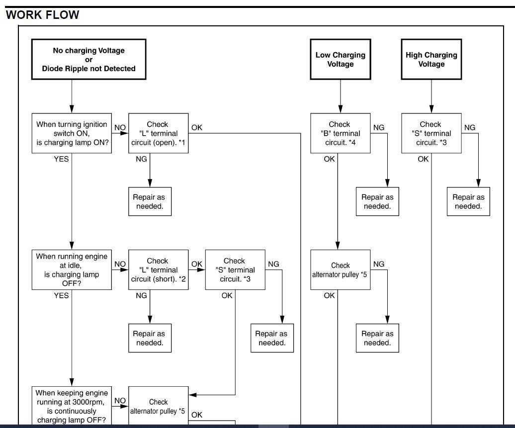

The FSM has a good troubleshooting guide for charging system issues like this.
https://www.nicoclub.com/infiniti-service-manuals
Typically if you have a battery light at idle but not at 3k rpm, they're going to tell you to inspect your alternator L terminal and S terminal and then belt tension. But it could be anything from loose battery clamps to crappy engine or chassis ground connections on the battery cables. Based on the light being on at idle and not at higher rpm i wouldn't suspect the alternator connector but those get old and brittle and the contacts can get crappy too. So you end up having to check everything to be sure everything's in solid shape. And if you're worried about getting stranded you can buy a little voltmeter that plugs into your cigarette lighter and will display the battery/charging voltage so if your alternator isn't working and you're running off the battery like a total loss system and will get stranded soon, at least you have a heads up so you can go into conservation mode (shut off electrical loads etc.) and make it to someplace safe or maybe back home if it's within a few miles. I went through all this recently.....
You don't say what year/model you have but here's what the FSM looks like for the 2006 G35 sedan.
