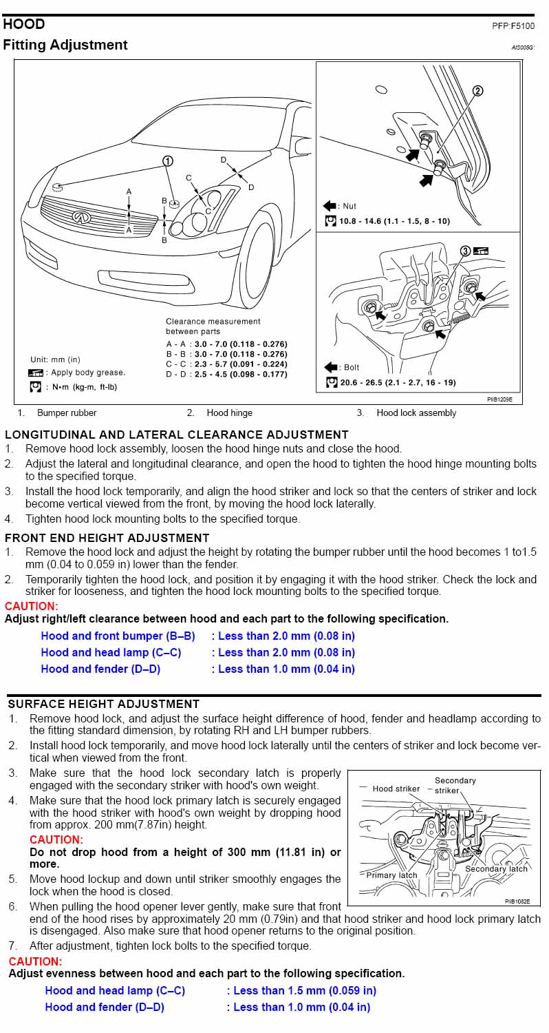

bythabay's Avatar
Posts: 2,174
Likes: 77
From: Santa Clara, CA
Originally Posted by htownboy
No need to loosen any bolts... Everything up there is light weight and can me adjusted with slight force.
Attempting to adjust the hood without loosening the correct nuts/bolts will cause damage to the hinges. Attached are official instructions from Infiniti on how the hood should be adjusted.
Old Jul 22, 2008 | 12:18 PM
htownboy's Avatar
Joined: Jan 2005
Posts: 982
Bull****! You will not damage the hinges with reasonable force! Comon man, you would need to really bend the hell out of the hinges to do damage to them... I have witnessed the adjustment done to MY G35 and I'm very happy with the results and have NO damage.
Do whatever you want; it's your time and money, but there is NO need to loosen anything. When you start breaking the paint on these bolts and move the hinges around you invite corrosion. A slight adjustment is better IMO.
