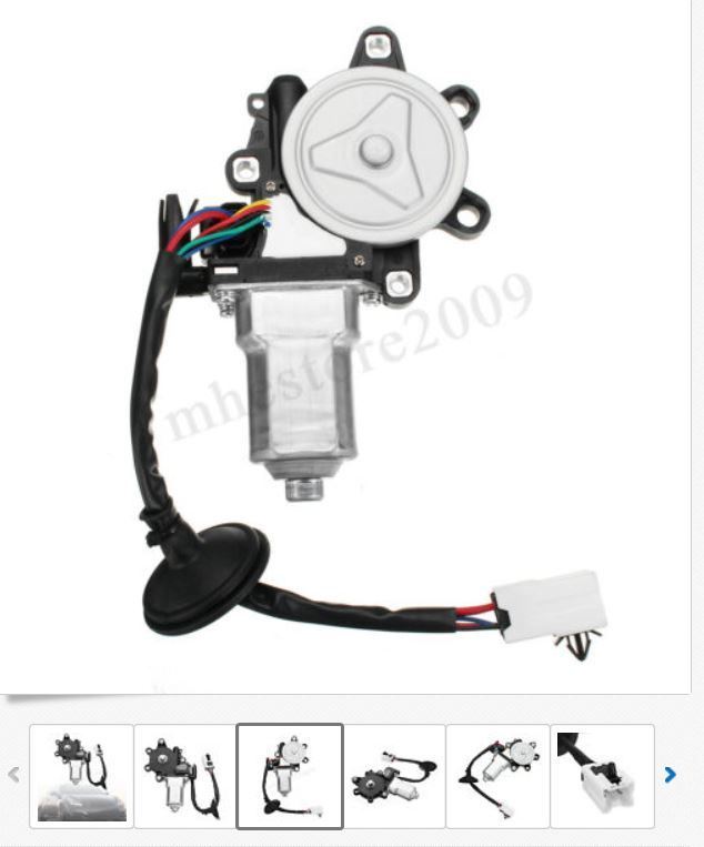

Yeah, there was not ''reset switch''.....see the picture. I have returned the motor. I have ordered a new motor WITH the ''reset switch''

Also, be very careful since it's not calibrated it likely isn't going to drop your window 1/2" when you open the doors and if it's NOT dropping the window you run a serious chance of breaking the glass when you try to close the door. As a short term way around this problem you can remember to drop the window a little before exiting the vehicle then put the key in the door lock and hold it to LOCK to roll the window back up, you will also need to hold the key to UNLOCK to drop the window back down before you enter the vehicle again.
Thanks for the tip. I changed the right motor around 2 years ago and every 2 months, I have to reset and setup the windows correctly. that's really a pain I the a.... Not sure why but it only takes me less then 10 min to set it up

If it won't hold calibration it's probably an indicator that the window regulator is wearing out.
