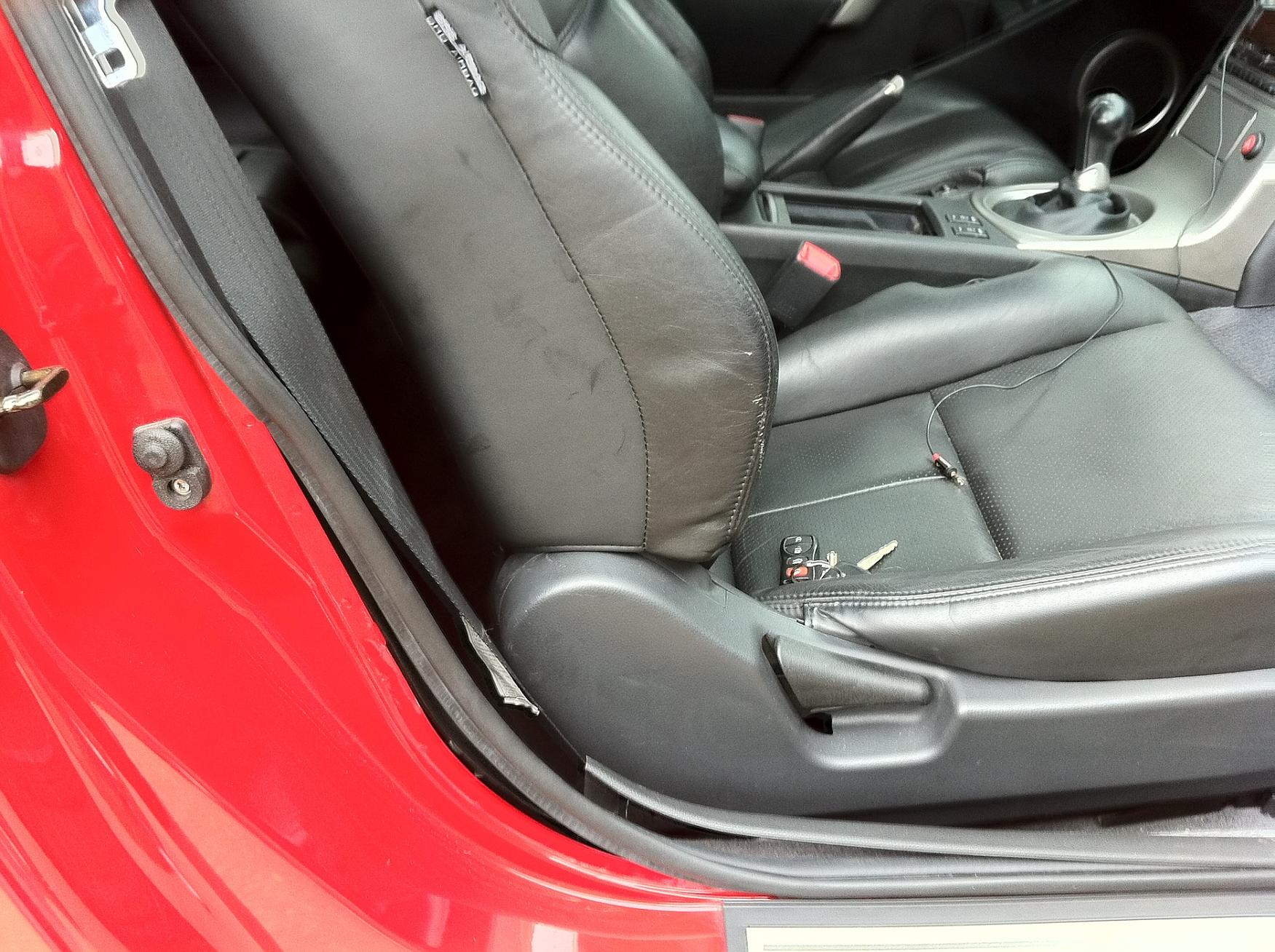

The weather stripping in my passenger door is starting to come off and was wondering if anyone else has had this issue? I have tried to re-work the stripping back into place but it will re-work itself back out off place after opening closing the door a few times...Do I need to replace the whole stripping or glue it down or what can I do to fix this?
Below is a picture...
Thanks for any help!

The weather stripping looks good, it just needs to be glued down. I think dealerships use Contact Cement, I'd probably use Super Glue which I use for everything....
Gary

Alright sweet just wanted to make sure that I didn't glue it and find out that it wasn't meant to be glued or something...
Thanks for your help Gary C!! as you always seem to answer my questions lol

Um, no glue on mine. I can pull it out and put it back into place w/o any issues. I guess the 'glue method' works. But I would get a new molding.

I don't feel comfortable using super glue. I would just use some extra strength glue made specifically for weather stripping.

Give 3M Super Weatherstrip Adhesive a try, AKA Gorilla Snot. It comes in a tube or aerosol
get the tube, available in most auto parts stores. Once you use it you will understand the alias.

Alright cool thanks. I will look for this tomorrow, I feel safer using something made for weather stripping rather than super glue...

I used the 3m black weatherstrip adhesive and it came off. I figured wth had some clear rtv silicone laying around. Few dabs and it is still is holding good.
