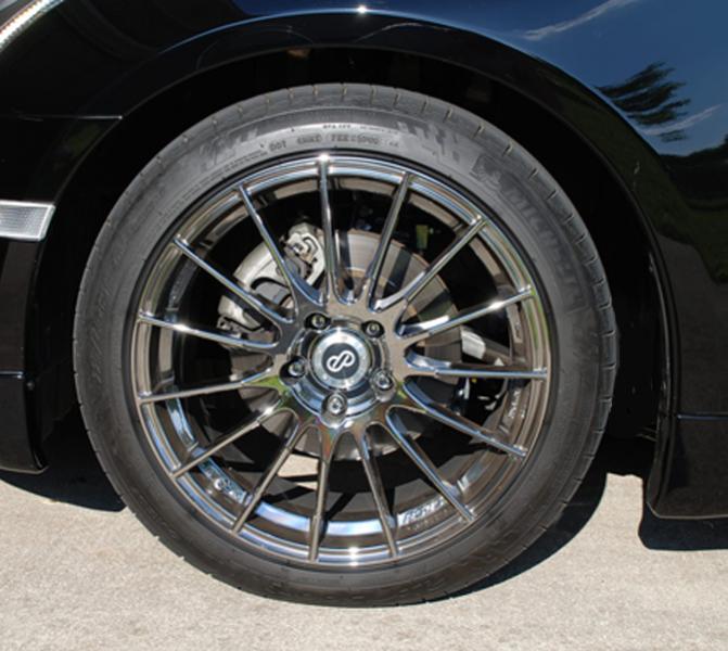

You need to post a picture. You'll get more accurate responses. What your describing sounds like just the brake pads are too long??? This is a fairly good photo of a 2003 non-Brembo factory rotor/caliper. Do your rotors/calipers look like this?
Attached Thumbnails Is it possible to down grade from Brembo brake system to regular infinity brake syste-rs05.jpg
