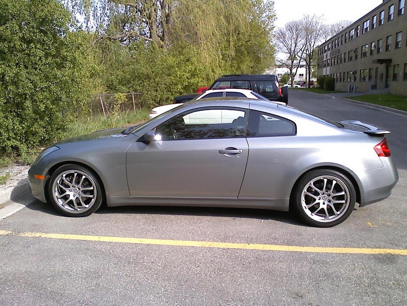

Here is my car, i'm pretty sure they are the same tires you mentioned?

Yup, you're good to go. Just take them to a reputable shop, don't let some ham-handed shop monkey scuff them all up for ya! Better yet, if you can swing it, get a spare set of less-worthy wheels to bash through the winter.
