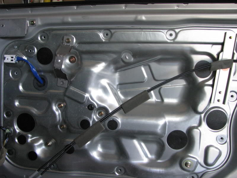

If its going halfway back down on you it, only rolling up all the way when you do it manually,.... means you need to reset the window motor. Its located inside the door panel behind a black sticker. Had the same thing happen to me.
Could you further explain where it is? a picture perhaps?
Its one of the smaller stickers in the middle, on the right side.
heres a link.. https://g35driver.com/forums/body-in...l-removal.html
