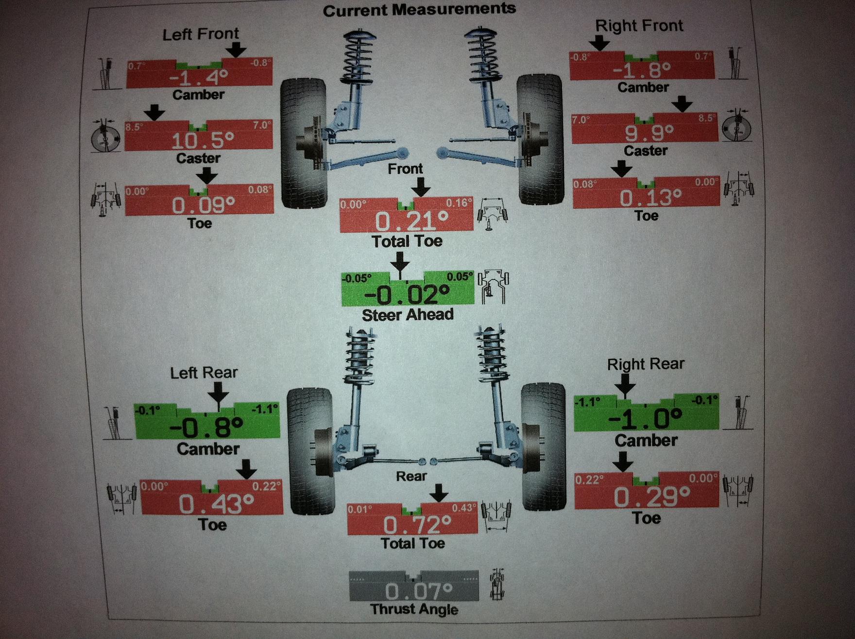

ok, i installed my df210 spring 3 weeks ago, 2 weeks ago put on my new rims and tires, just get my alinement done today. after alinement i noticed that my steering wheel vibrate a little at 75+ mph. so i'm thinking maybe alinement is bad. btw im pretty sure they balanced wheel when i bought it. any input will be appreciate. attachment is alinement report sheet.

If that is your "After" alignment specs, you need to take it back and have them get your toe back in spec or say bye bye to your tires.

well, they said thats the closest they can get to factory spec. another anlinement shop?

you might need camber kit w toe bolts.

sry, forgot to montion. i had both front & rear camber, and toe bolt.

All the "RED" items means the numbers are out of spec.
Check your suspensions, bushings and so on. They may all need to be replaced.
Also, check your compression rod bushings. Those things go out quick.
Also, the G's and 350z both have horrible suspensions right out of the dealership.

There is no reason they shouldn't be able to get your toe back in spec. I'm slammed and my alignment shop was able to get my toe back to 0.

thank you for all your input~ im going back tomorrow and ask them to get everything back into spec. ill update.
