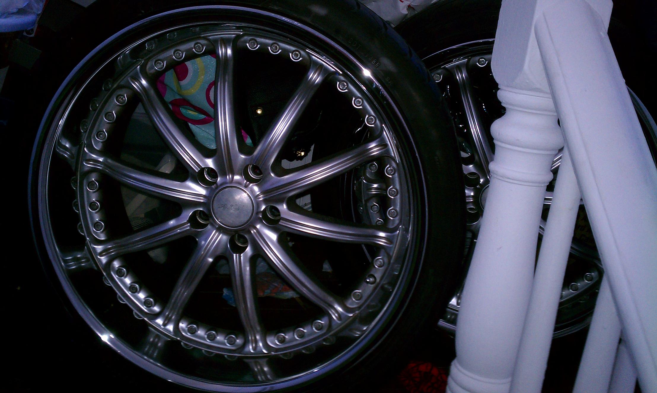

im having a problem with a new set of rims . the hole where studs go through its to deep and the studs are not long enough.. how can i fix that maybe wheels spacers with the studs?, but i really don't want the wheels to be sticking out the car....please any opinions ....

i have a new set of DONZ 20'' wheels and the studs on my car are to short they wont reach all the way through to screw the lugs on it...heres the picture of the rim

i was thinking of extended lugs maybe

Get aftermarket lugs.

Instead of changing the studs?

My first thought was that you're using the wrong lug nuts for the wheels you bought. Most large tire shops should be able to supply you with lugs that reach deeper into the wheel....check em out!

Extended Studs: http://cgi.ebay.com/ebaymotors/10x-I...Q5fAccessories

I just changed the studs on my car (broke one) and it wasn't too bad. Remove the brake caliper and bracket, pull off the disc, whack away on the studs with s hammer, put new studs in, bolt them down fully, reassemble. Not too bad, follow the DIY on my350 and have pb blaster handy. Got the extended studs from z1motorsports.

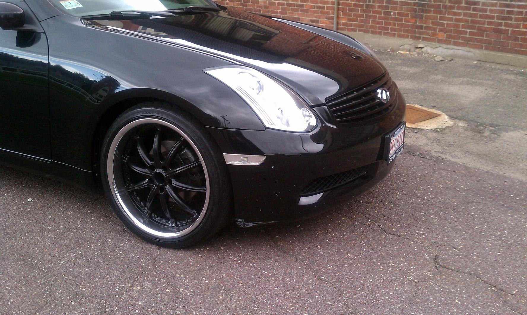

got them on already thanks...i already figure it out..
Old Aug 5, 2011 | 01:15 PM
ThatOneDude's Avatar
Posts: 1,611
Likes: 182
From: WASHINGTON STATE
So, what did you do?

Nice, so how did you get them on without extended studs?
Old Aug 5, 2011 | 03:00 PM
irishsig's Avatar
Posts: 2,288
Likes: 51
Maybe he got a diff set.
The 2 pics are of 2 diff sets of wheels.
Same brand, diff finish.
