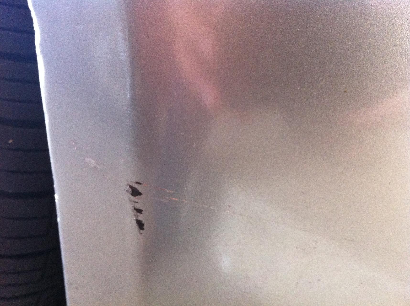

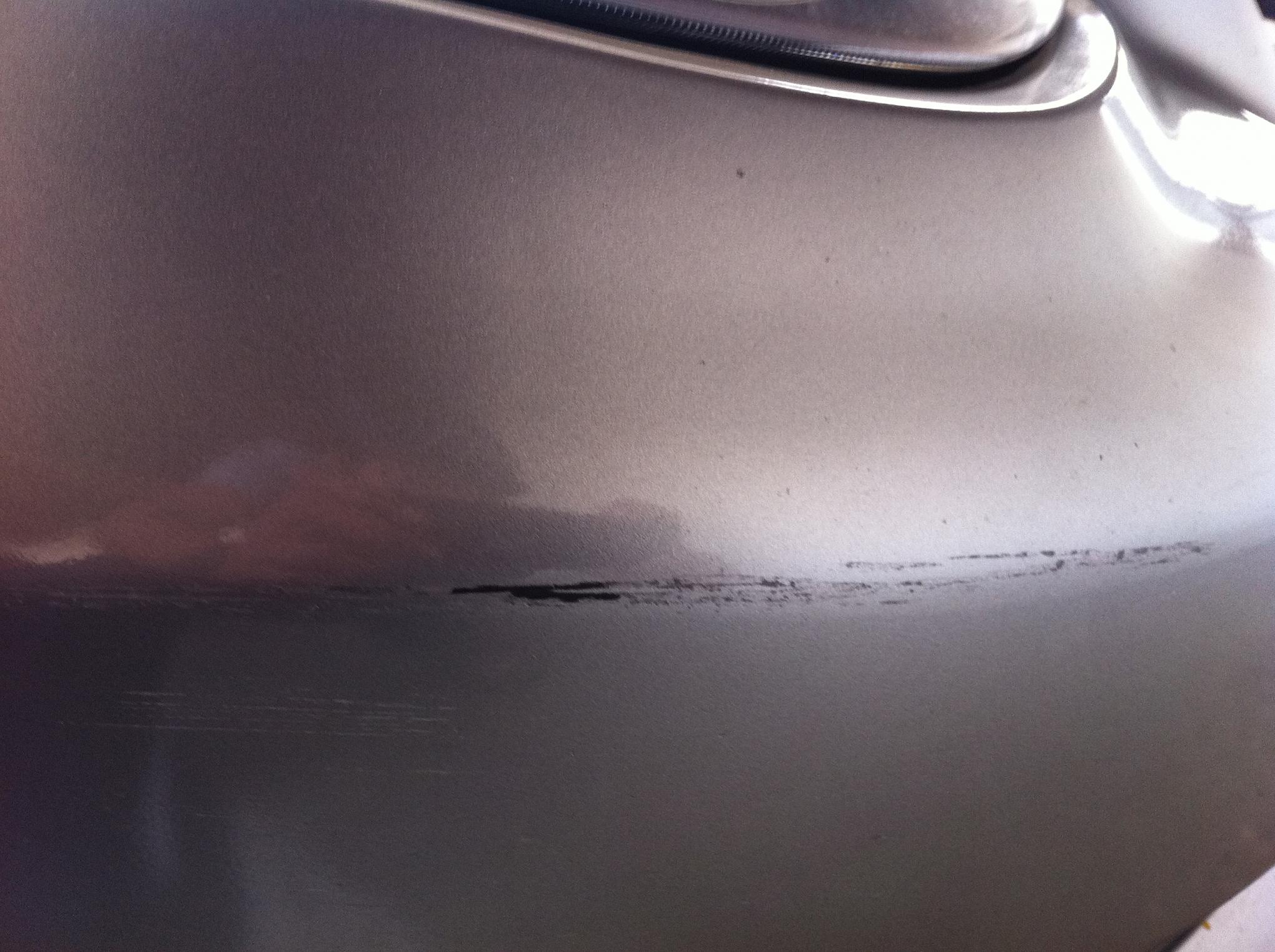

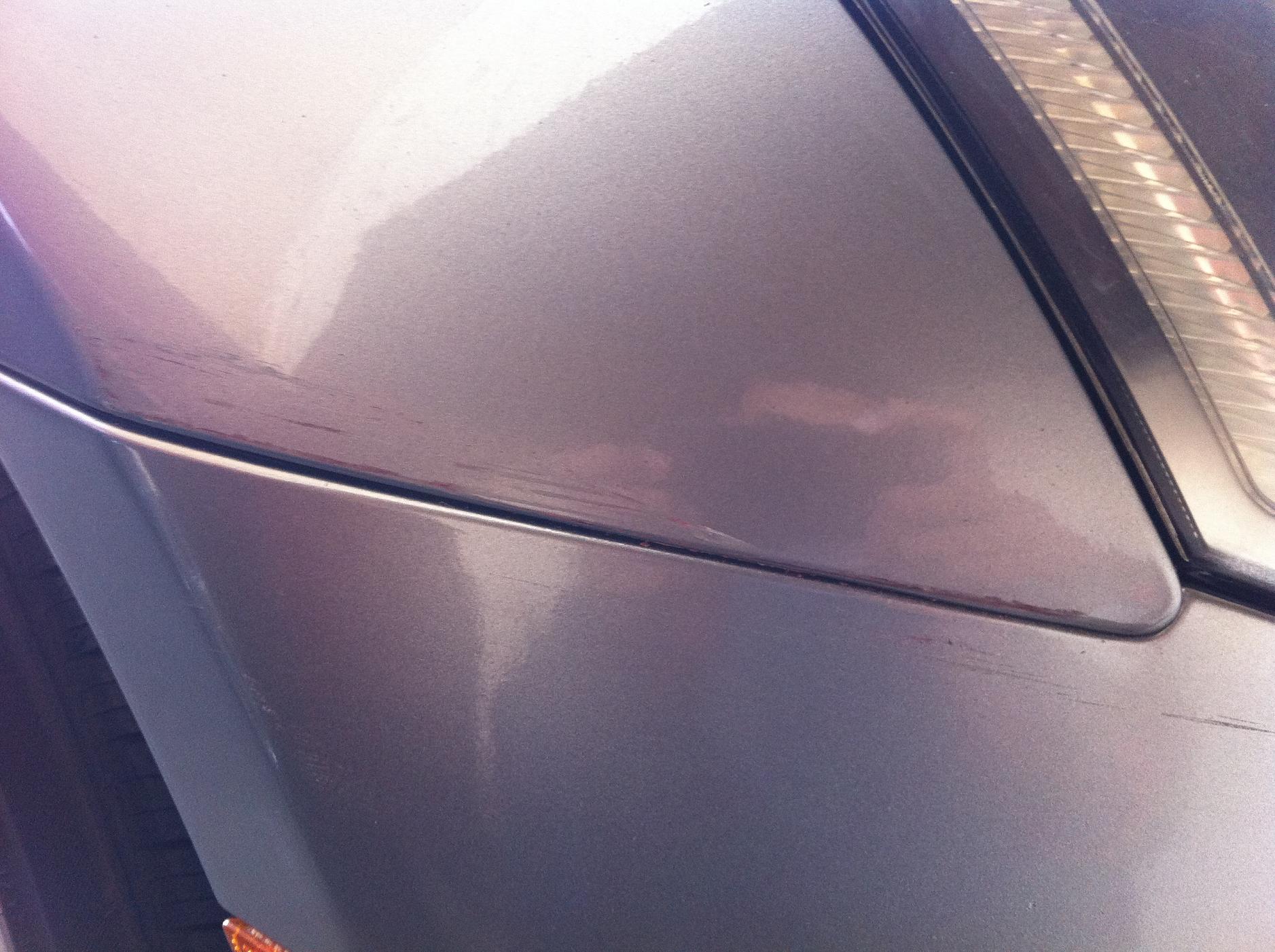

Help me getting rid of these scratches, some careless ***** scratched me ride badly. See the pics and give some ideas please!
Attached Thumbnails I want to get rid of these scratches!!! Pics Attached-img_2400.jpg   I want to get rid of these scratches!!! Pics Attached-img_2402.jpg   I want to get rid of these scratches!!! Pics Attached-img_2403.jpg

Some of those look too deep to buff out but most of them should buff out with a good random orbital or some elbow grease. For the ones that don't, some touch up paint might not be a bad idea. It won't look perfect but it should be much less noticeable.

yeah only choice is to use touch up paint
those scratches are through the paint, that black part is the actual bumper
touch up paint, wet sand, add new clear, wax wax wax

Depending on how much you care about your car and how **** you are. The only true fix is off to the body shop to have it professionally done. Yes you can try Dr. Colorchip but it is not cheap and in all the photos I've seen other than the Dr.Colorchip website it will show. There is another product called Langka but I don't believe it comes with touch up paint.
yea that black isnt something that u can just cover up ur better off shopping around for a paint shop to get ur bumper painted

You could have your bumper repainted but try this first, get touch up paint from the dealership. Take your G to the local full service car wash and have one of their guys work on those scratches with a high speed buffer, that should remove/blend 85%. What's left you can easily cover with the touch up paint, then put on a good coat of wax. Even if you're a detail freak like myself this should look good and it didn't cost you $300 to $500....more like $30!
