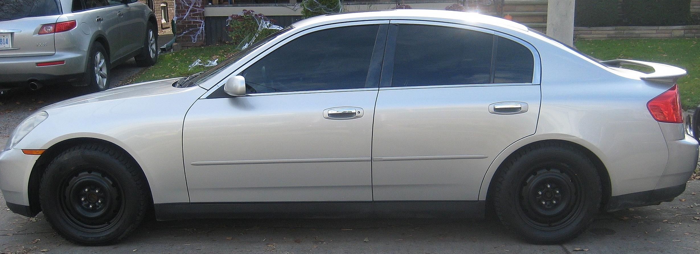

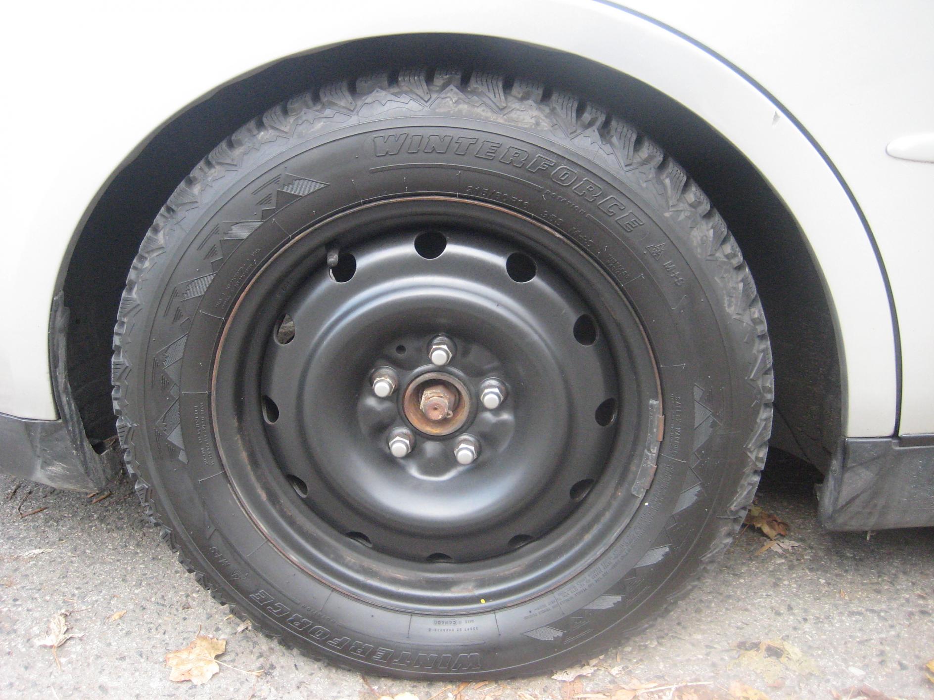

I would think that the width of the tires would make no difference with VDC. If you get much snow I would recommend all the same width. You could even go narrower for deep snow.
You want to cut through the snow and get to the asphalt, not push the snow which is what wider tires will tend to do.
I went to a 16 inch steel wheel for my snows which allowed me to go to a 215/60R/16. Gives me a bit more height on the sidewall as well.
This setup worked awesome for me last winter.
any pictures of that setup on your car?

I'll get a pic of it up. Not sure if he could run the exact same setup since I have an 03 sedan. And my car isn't lowered. But a tire shop can give you the wheel and tire sizes that will maintain your diameter within spec for your speedo readings.

215/60R/16 WinterForce on 16" steel wheels. 2003 G35 Sedan. Stock height.
Attached Thumbnails Snow SET UP-img_3134.jpg   Snow SET UP-img_3135.jpg   Snow SET UP-img_3133.jpg
